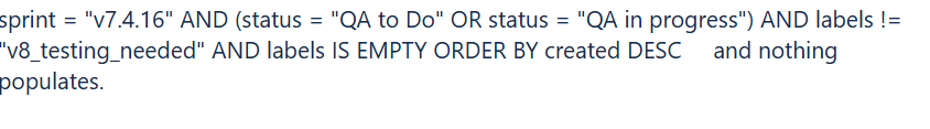

Heather Driscoll
May 12, 2025
Trudy P Claspill
May 12, 2025
Hello @Heather Driscoll
Your syntax is incorrect.
I think if you tried to just execute the labels portion of your original filter you would find it would not return any results:
labels != "v8_testing_needed" and labels IS EMPTY
Try this
sprint="v7.4.16" and (status = "QA to Do" or status = "QA in progress") and
labels != "v8_testing_needed" OR labels IS EMPTY )
Put parentheses around the labels criteria and separate them with OR rather than AND.
I don't believe that is actually going to get you the results that you want, ultimately. I don't think the results will include issues that have the specified label plus other labels.
