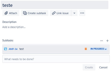

When I create a Subtask and change the status "TO DO" to "IN PROGRESS" according to my workflow process, it appers in the next board.
1) I created a task
2) I put a subtask that automatically goes to "TO DO"
3) I change de current status from "TO DO" to "IN PROGRESS" in the subtask
4) This is appearing in Kanban Board and shouldn't do it.

Gabriel Baggio
June 11, 2021
Hey Bill,
Thanks for your answer!! I need to not appear on the board because it is more clear. And the subtask needs to stay in the main task, not appear separately.

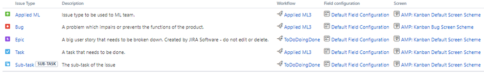

Gabriel Baggio
June 14, 2021
Really Thanks Bill for this step-by-step guide!!
I've made all of the steps above, and this message appears:
The value 'subtask' does not exist for the field 'issueType'.
Do you know what can I do?
Thanks for your time Bill!!
Here is a photo of my Issue types:
Bill Sheboy
June 14, 2021
Hi!
Sorry, I was listing both of the common spellings of sub-task, as some companies have added multiple values for that issue type.  Please drop the ones that don't work.
If this helps solve the issue, please consider marking this question as "answered".  That will help others in the community find solutions faster.
Thanks!
Gabriel Baggio
June 14, 2021
Thank you too much, Bill!! You really solve my problem!!
I just made some adjustment, and I rephrased to this:
AND issueType not in (sub-task)
 And It really works!! I'm not able to see the subtask on the board now!!
