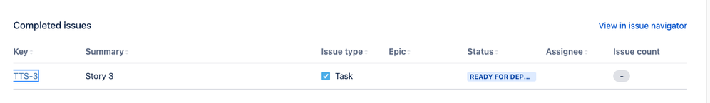

This is from a Sprint Report where TTS-3 was originally set to Done, but in the workflow change process I mapped the Done status for a Task to the new blue Ready for Deployment status.

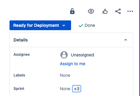

And this is what I see when I view the issue directly.
