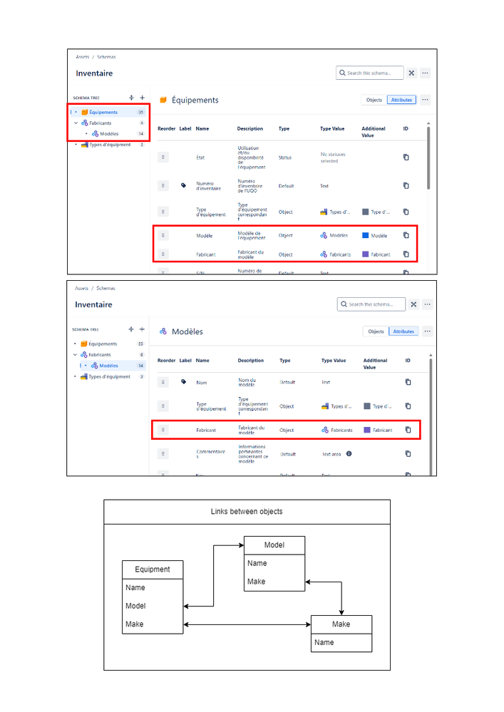

I am trying to create the structure for our equipment inventory in Jira Assets. So far, we created a "Make", a "Model" and an "Equipment" object types and we gave Equipments an attribute for Make and an attribute for Model. This way, we can tell the make and model of any equipement and everything is available in the Equipment view/list.
That said, I think it would make more sense if Model had an attribute for it's Make and Equipment only had an attribute for Model. That way, we wouldn't have to set a Make attribute for multiple equipements of the same model. The problem with this solution is that the Make isn't shown when consulting the Equipment unless we look at the object graph and set the depth to 2. It was much easier when all the information was available in the same screen.
A third solution we tried was to give Model an attribute for Make while ALSO giving Equipment an attribute for Model and Make. That way, the information was available in the Equipment screen AND there would be a link between Make and Model. Now the issue with this is that there is two Make attributes to set (one for Model and one for Equipment) and they could be set differently by mistake. Using this solution, I tried to limit or at least filter the Make and Model fields of the Equipment objects so that when a Model is selected, only the linked Make is available and vice-versa. The closest I have gotten is by filtering the attributes using a AQL like this : "object having outboundReferences(Name=${Make})". It seems to do what I want it to but I get an error when selecting a object (Object: INV-XXXX is invalid due to restrictions) and if both fields are empty, there aren't any options to chose from since the filter doesn't find any objects that match.

Here are a few screenshots and a diagram of what currently seems like the best solution. The object types are in French in the screenshots. Just know that "Nom"="Name", "Fabricant"="Make" and "Modèle"="Model".
The issue with this setup is that there are two "Make" attributes. One for the Equipment and one for the Model and they can be different. I need to find a way to make sure that the attribute "Make" of an Equipment always corresponds to the attribute "Make" of the Model chosen for the equipment.

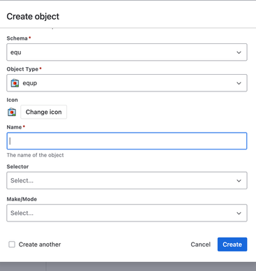

However, you might be able to do a selector of all Make and Model in one field, and then set the next field with the appropriate value,
is that something that could help you?
see image.

David Audet
May 23, 2025
Hey @arielei
Yes that does look interesting! How can you select different object types in the same attribute? How would you filter the next field to automatically set the right value?
Thanks
arielei
May 23, 2025
Hey  @David Audet
If you have a parent -> child objects then you can create an attribute for the parent object and in the "Attribute Settings" -> General - Include Children
There isnt a way to do that, so my advise is:
Tell agents to fill ONLY one param for their choosing - Model or Make - and then write an automation that will populate the correct value to the other attribute.
For that, you will need to have some naming convention on how to create Make or Mode to base the automation on it.
