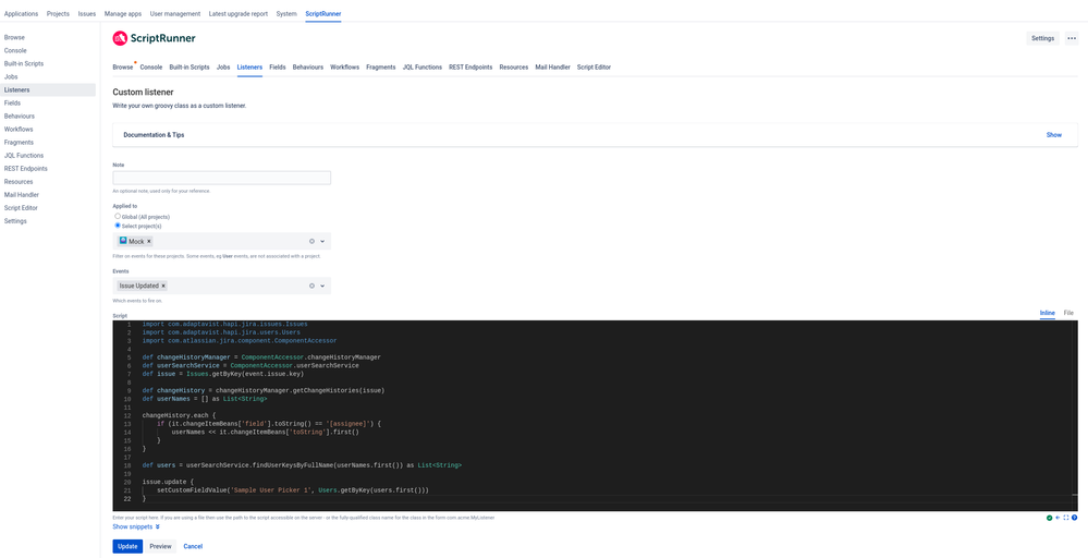

Below is a screenshot of the Listener configuration:-
With this Listener, the User Picker field will always be set to the First Assignee, no matter how many times the Assignee is to change.
Please note that this sample code uses ScriptRunner's HAPI feature. To be able to use this feature, please ensure that you upgrade your ScriptRunner plugin to the latest release, i.e. 8.3.0.

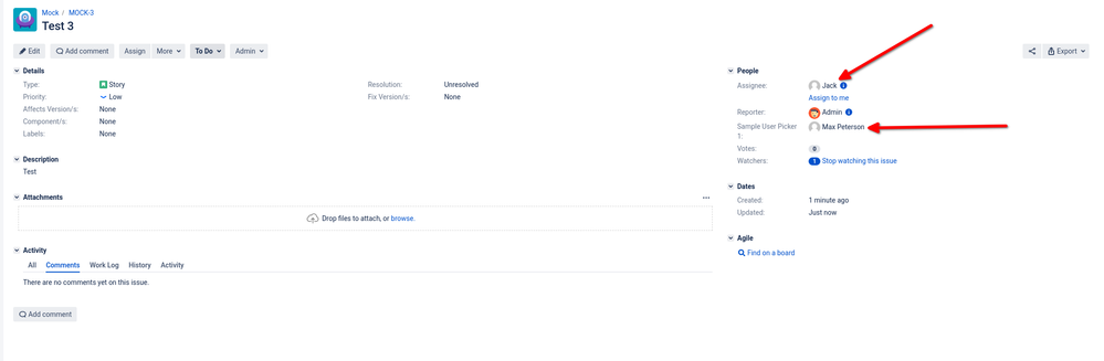

Below are a couple of test screens for your reference:-

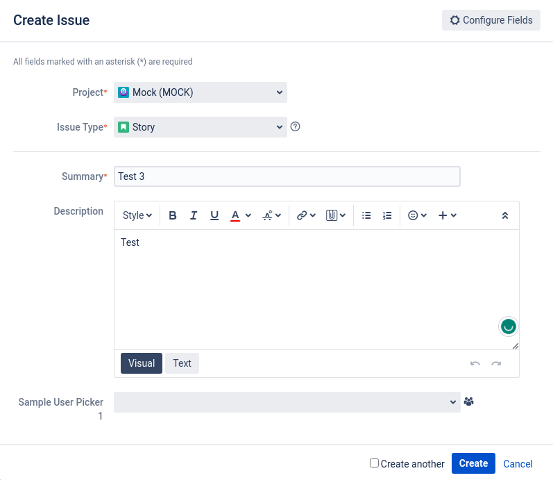

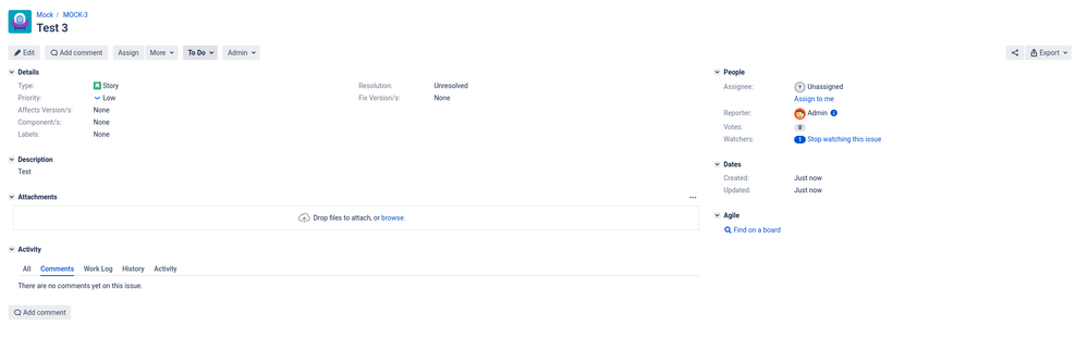

1. When the issue is first created, no Assignee has been added; hence the User picker field is not updated as expected, as shown in the screenshots below:-

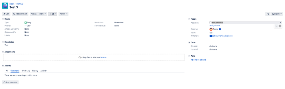

2. Once the Assignee has been selected, the User Picker field will be updated as expected, as shown in the screenshots below:-

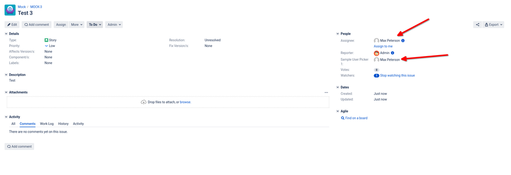

3. Once the User Picker field has been set, even if the Assignee changes, the User Picker field will still retain the first selected Assignee as shown in the screenshot below:-
