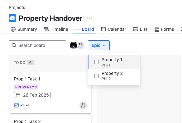

What I would recommend is that you create an Epic for each property, and create child Tasks under each Epic for the the specific property.
You could have one board to display all the tasks to which you could also apply the Epic filter to display the tasks for 1..n properties at a time.

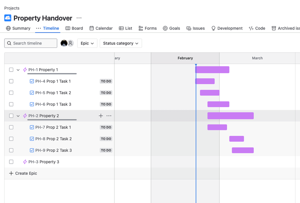

With all the issue available for view in the one board, you could use the basic Timeline feature available with the board to see the timelines of all property work at once.
