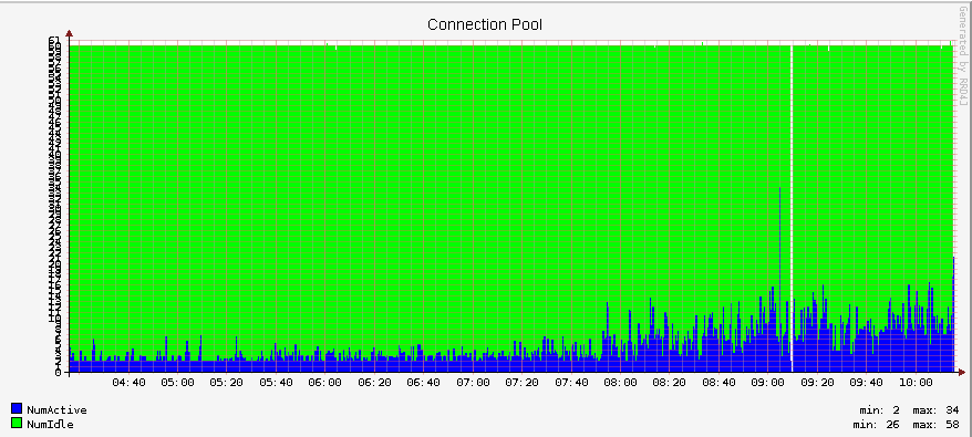

We are using JIRA Software Server and we have an almost 122519 issues in our instance. We are facing very frequent slowness in the issue processing and JSD queues, even DB connection pool shows high spikes graph everyday.
Please help us to configure the best DB connection pool settings.

Sami Ahmed Shaik
January 29, 2023
Based on our current instance performance, is it OK to set the JVM as follows.
Min: 4096mb
Max: 4096mb
We normally see performance issue when there are spikes in the DB pool as follows,
How can we fix such issues? any idea @Daniel Ebers & @Gonchik Tsymzhitov

Gonchik Tsymzhitov
January 3, 2021
Hi!
for the best one you can find using increase.
But if you see spike, better to find the bottle neck.
Why RDBMS response slowly? Is this some add-on use non-optimized request?
Did you tune your RDBMS ?
