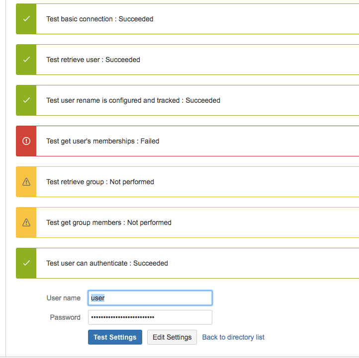

What else can cause a LDAP auth to fail, even when the test succeeds?

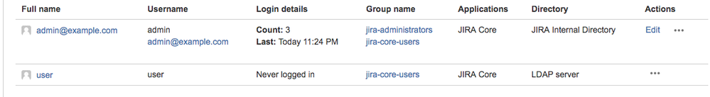

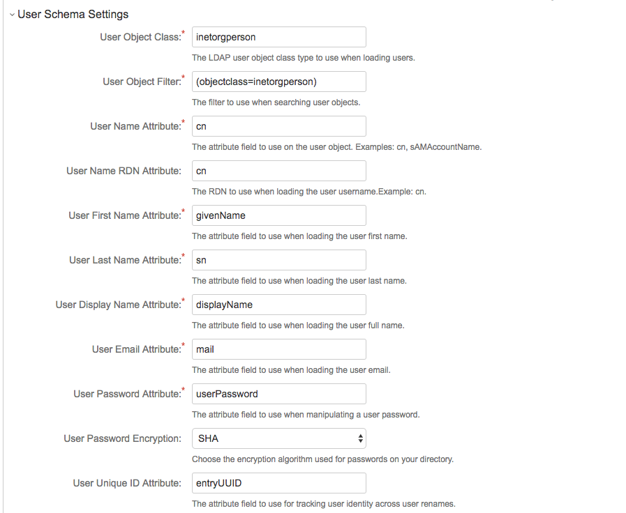

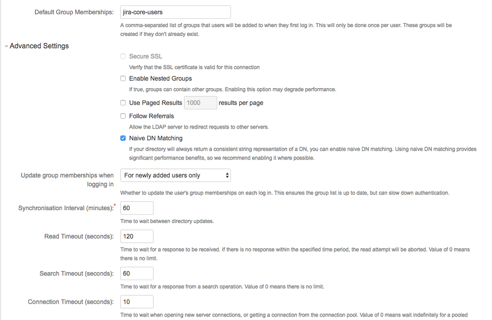

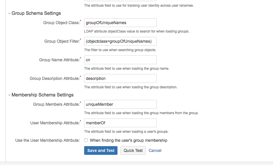

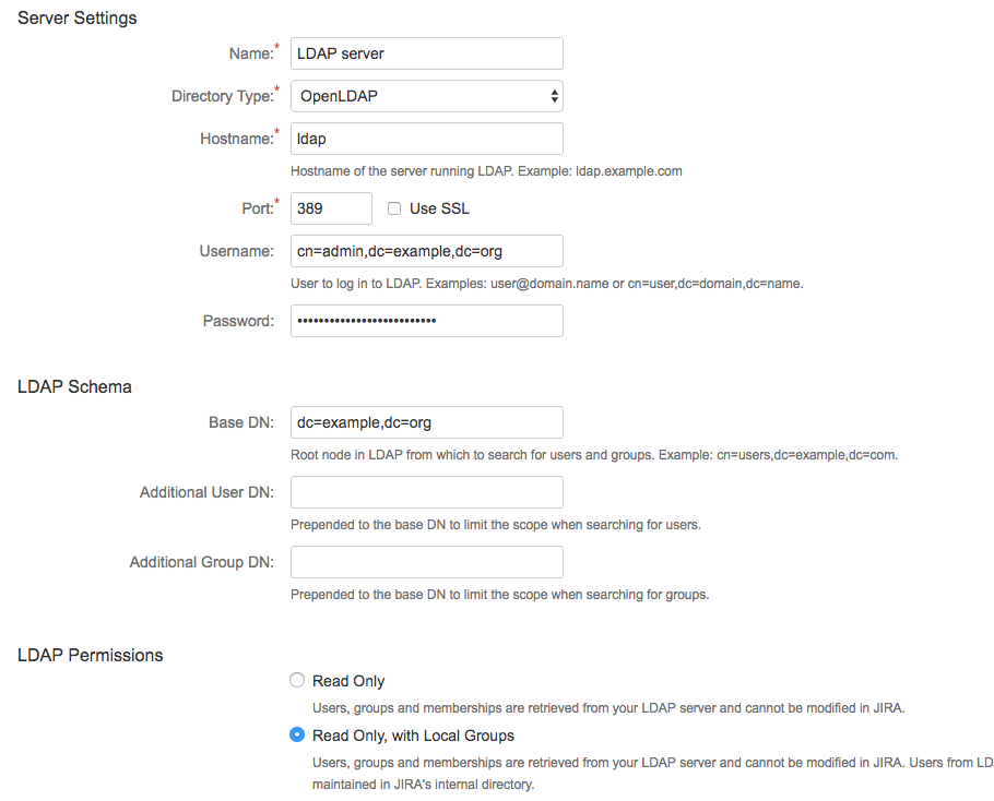

LDAP settings:ldap-1.pngldap-2.pngldap-3.pngldap-4.png
User found by JIRA and passes auth test:

Does the user info ever show attempted logins? Seems the membership config needs attention. I can try and configure the same on my local and let you know what I find.
Jordan Glassman
February 10, 2018
The users listing in the above screenshot shows "never logged in" for the user "users".
Is there somewhere else to check attempted logins?
