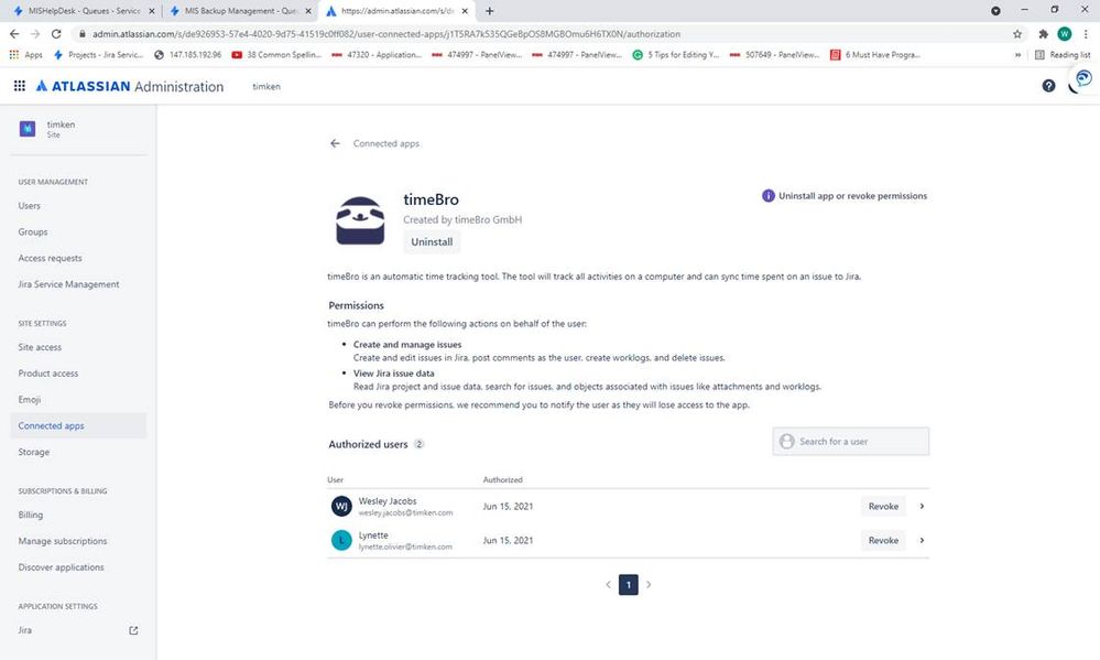

Yes, it is the timebro app.
They had it installed and tried to reinstall it a couple of times. Now they are waiting for a solution, because when it was installed it worked for everybody but one user.

tha app is installed/connected since June 15.
I hope that belps.
