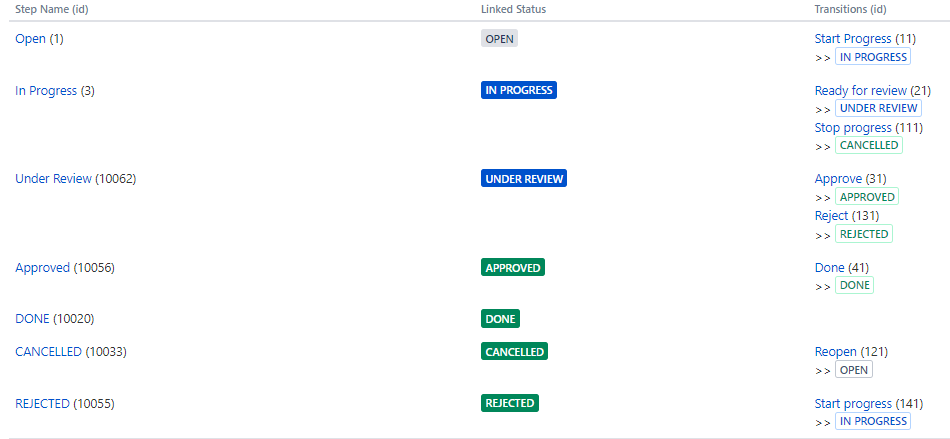

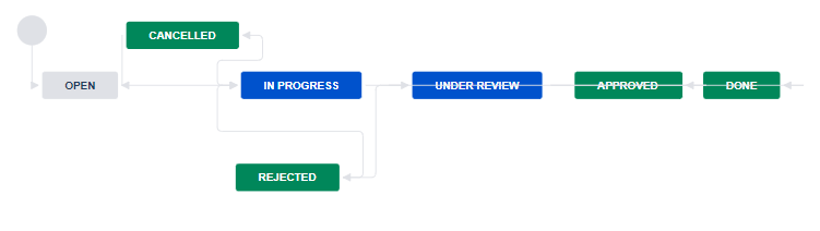

Sorry, if my wording is confusing :).  Like you, I often use "Issue Tracker" and I understand the "transition" states of moving the issue forward.  Maybe this diagram will help.
A very simple workflow used by many of my teams in the past was:
At my current organization, there are no transition steps.  I hope that clarifies, I'm certainly not asking for anyone to over think this, I was simply curious.

That helps, it shows us what you have, but I don't see how you have "no transitions".
Both diagrams show transitions.

It's the same workflow, I showed the text and diagram for reference.  That's one from my past.
If the workflow were in my organization today, it would simply say "All" after each status, similar to this.  (Note, this is not meant to be the same workflow, it's just an example)

Ok, so not "no transitions", just starting simple with a full set of "all" transitions.
You should add transitions (replacing all) when you have a process that is constrained.  For example, the original Jira workflow was a map of a process that Mike and Scott wanted to follow.
Broadly, it is Open -> in-progress -> Resolved -> Closed -> Reopened-> Resolved, with some other "go back one step" transitions.
"all" transitions won't work in their process, because you never want to let an issue go back to "open".  If it needs more attention, it should go to re-open.
I completely agree with Jack here - a workflow built of "all" transitions by default is a good starting point.   If you have a constrained process where you don't want to let people make mistakes, or it turns out people are abusing the "all"s, then you start defining transitions for them.
You may also want to control or execute different things in your workflow, and you should be using dedicated transitions when that happens.
An example I've set up recently - effectively an approval of sorts - an issue needs to go from "open" to "approved".   When Alice does it, we want a line of text written to a file on the server,   When Bob or Charlie do it, we don't.  We set up two transitions from open to approved, one with a condition "only Alice can do it" and the other with "only Bob or Charlie can do this", and Alice's transition has a post-function that writes to the file.
