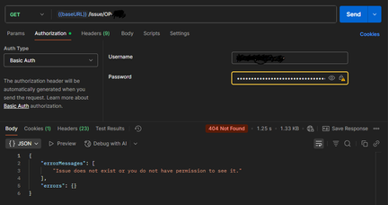

Hi everybody,

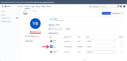

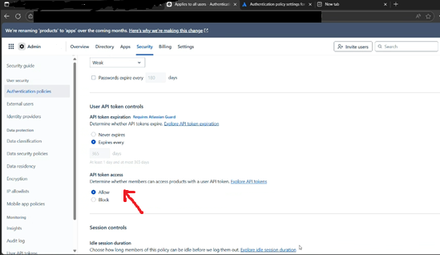

I am a managed user in our Jira Cloud instance (basic Atlassian plan). I am part of a group with the 'view project' (Browse Projects) permission, and I have Jira Software access as a user. API token access is enabled for users in our organization.
  • I can view projects and issues via the Jira UI.
  • API requests using Basic Auth (email + API token) to the REST API v3 consistently fail, either with authentication failure or I get empty results (no projects or issues).

  • I am licensed for Jira Software
  • API token access is explicitly allowed for managed users

Hey @Gor Greyan
Thank you for your prompt response!
However, I have tried accessing multiple issues and consistently receive a 401 Unauthorized error, even when calling the /rest/api/3/myself endpoint. Does this suggest that the problem is broader and likely related to my overall permissions or authentication setup, rather than specific issue restrictions.

Dear @Yash Bhatia
Here are some points, that you can double check.
  • Use an API token, not a password
    Go to [id.atlassian.com → Security → API tokens → Create API token]*.
    Postman → Authorization tab → Basic Auth:
    Username = Atlassian account email
    Password = API token
    (Not the normal Atlassian password.)
  • Make sure Postman is sending the header
    Authorization: Basic <base64(email:api_token)>
  • IP allowlisting: if the org uses IP allowlists, their machine’s IP must be added.
