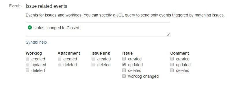

kororos
November 18, 2017
How would I add Issue Closed to the webhook trigger? This is a fixed list where there is no "issue closed" event. See screenshot:
Alexey Matveev
November 18, 2017
Yes, you are right. Not all events are available. I guess the only choice to add the update event. Or to fire it in the transaction as a post function.
