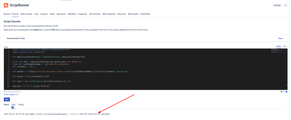

Below is a screenshot filtered result that is returned:-

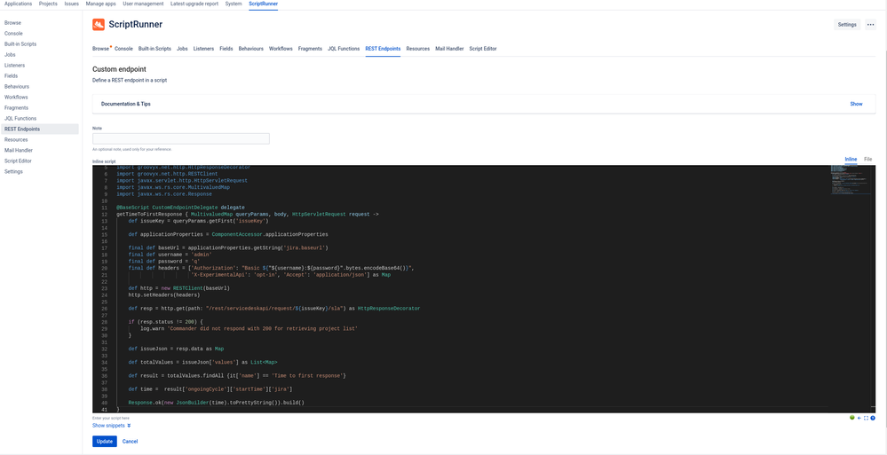

Below is a screenshot of the REST Endpoint configuration:-

For this code to work, you need to configure the REST Endpoint and not just invoke it from the console.
Once you have configured the REST Endpoint, you can now invoke the REST Endpoint from the ScriptRunner console doing something like:-
import com.atlassian.jira.component.ComponentAccessor
import groovy.json.JsonSlurper
def applicationProperties = ComponentAccessor.applicationProperties
final def host = applicationProperties.getString('jira.baseurl')
def issueKey = 'ST-1'
def baseUrl = "${host}/rest/scriptrunner/latest/custom/getTimeToFirstResponse?issueKey=${issueKey}" as String
def output = new URL(baseUrl).text
def json = new JsonSlurper().parseText(output) as List
log.warn "=====>>> ${json.first()}"
This should return your date value. Using the code above in the Console should return something like:-

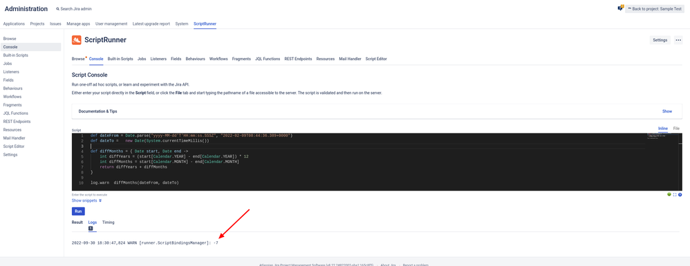

My questions are:-
1) For "Time to first response" we are getting a date "2022-02-09T08:44:36.389+0000" from rest api but in jira UI it shows -8mon. Why is there a difference?(Issue-SPSDT-68)
2) There is one more Jira for which it shows -1mon in jira UI. But the rest api is giving no date because it has no ongoingCycle how to handle this case.Rest endpoint payload for this issue i have posted in my previous comments, please refer?(Issue-SPSDT-69)
3) Also, is there noway we can get "Time to first response" from customfield value object rather than calling rest apis?
Basically, Jira is doing a calculation between the number of days or months from the Time to First Response and the current system date. In other words, something like:-
def dateFrom = Date.parse("yyyy-MM-dd'T'HH:mm:ss.SSSZ", "2022-02-09T08:44:36.389+0000")
def dateTo = new Date(System.currentTimeMillis())
def diffMonths = { Date start, Date end ->
int diffYears = (start[Calendar.YEAR] - end[Calendar.YEAR]) * 12
int diffMonths = start[Calendar.MONTH] - end[Calendar.MONTH]
return diffYears + diffMonths
log.warn diffMonths(dateFrom, dateTo)
So the output will display the total number of months, i.e.
Basically, once you have obtained the value from the REST Endpoint, you can use the console, for example, to update a Text Field with that value.
