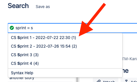

If you are talking about searching for issues in the Issue Navigator screen and then using the Bulk Change option to change the Sprint field, then what you must enter there is the behind-the-scenes unique numeric ID assigned to the sprint by Jira. You can't enter the name of the sprint. The name of the sprint is what you see in the Jira board. To figure out the ID of the sprint you can go to the Issue Navigator screen and enter the criteria to search for the sprint by name.
As you start to type in the name of the sprint there, you will see a list of possible matches displayed. The ID of the sprint is shown in parentheses.
