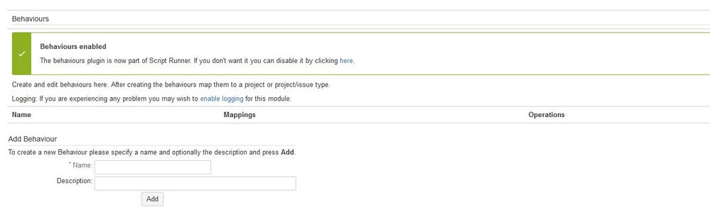

In this case, the warning mentions behaviours\validators, so you know it is going to be in there.  Go to admin -> ScriptRunner -> Behaviors and have a look through all the validator type ones, it looks like a behaviour is trying to execute on a screen that does not have any issue context.

we do not have any behaviors configured..
