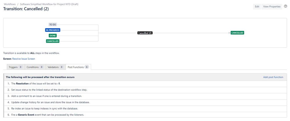

Karthikeyan Devi
August 11, 2020
@Nic Brough -Adaptavist-  Here is the screen Capture of my Post Function, I don't see any Condition to clear Resolution.
August 11, 2020
Ah, you're not using the standard post-function I usually use.  See the first post-function on the list - that needs to be removed.
