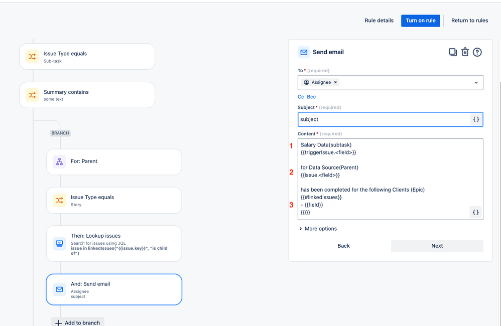

Trudy P Claspill
July 17, 2024
Since your Parent and Epic issues exist in different projects you will have to create this rule from the Global Automations screen. You will have to set the Scope to Multiple Projects and you will have to set Projects to all the projects that could be involved.
You may want to add a Condition after the Trigger to proceed only if Project = POCBA, so that the rule will proceed only if the subtask was in the expected project.
A rule like this should work. (Ignore the issue types I've specified. Use the values you are already using.)
In the above I am using a Lookup Issues action with a JQL statement to get all the Epics that are linked by the "is child of" link to the parent of the subtask that triggered the rule. Here are some reference relevant to that:
https://support.atlassian.com/cloud-automation/docs/jira-automation-actions/#Lookup-issues
https://support.atlassian.com/jira-software-cloud/docs/jql-functions/#linkedIssues--
In the above there are three sections to the email content.
In section 1 you print information from the subtask. Use {{triggerIssue}} to reference that issue and include any field you want to print from that issue. Of course you need a separate smart value for each field.
In section 2 you print information about the subtask's parent. Use {{issue}} to reference that issue.
In section 3 you are printing information about the Epics linked to Parent. These were obtained in the Lookup Issues action and are contained in a list object referenced by {{lookupIssues}}. Using this syntax
{{#lookupIssues}}
...tells the system that you want to print information for each issue in the lookupIssues list.
In between those two lines you put smart values naming just the fields that you want to print. So you would say {{key}} to print the issue key, {{Summary}} to print the issue Summary, and so on. If you wanted to print the issue key and summary for each linked epic then you could use:
{{#lookupIssues}}
{{key}}: {{Summary}}

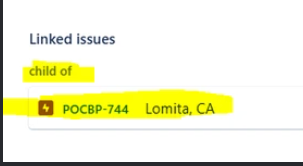

Trudy P Claspill
July 17, 2024
You need to use the text you see in the Linked Issue section that shows the relationship between the Parent and the Epic - "child of"
Like Brandon Garrett likes this
Brandon Garrett
July 18, 2024
Trudy,
It works!  You are amazing.  Thank you so much for your thorough and quick help!
