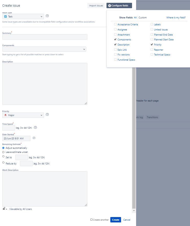

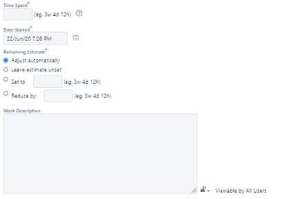

I am planning to REMOVE/ MAKE NON COMPULSORY of 3 COMPULSORY marked fields, which creating a task in the backlog. However, after doing a lot of research, I am still unable to remove them
The 3 fields to make NON COMPULSORY are,
1. Time Spent
2. Date Started
3. Remaining Estimate
Please help

Amitava Mallick
June 22, 2020
Hello @Trudy Claspill
I have tried going into "Configure Fields" but these 3 fields that I'm trying to make optional are not there. Atleast I couldn't seeTASK FIELDS.jpg

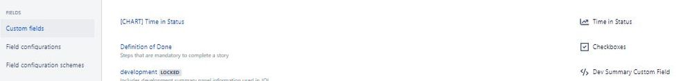

Amitava Mallick
June 23, 2020
@Trudy Claspill Hello. Thank you for the guidance
Believe you were pointing towards this Field Configuration Scheme and Field configuration. I looked into them, for the field "Remaining Estimate" however, couldn't find.

Logging Work should be a separate activity from creating an issue. Are you saying that when you Create a new issue in a project the Log Work dialog opens automatically and you can't create the new issue without logging work?
Amitava Mallick
June 23, 2020
While creating a TASK, the above 3 fields are marked as MANDATORY with a RED ASTERISK. I want to REMOVE the RED ASTERISK, or make those 3 fields NON MANDATORY
Trudy P Claspill
June 24, 2020
Check in the Field Configuration for "Log Work". That is the item that represents the Time Spent, Date Started, and Remaining Estimate fields.
