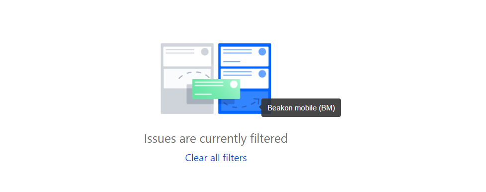

I have tried the same JQL search as I also want a quick filter to sort my KANBAN by due date.  I keep getting the following message.   I clear all filters, no luck
Andy Heinzer
June 5, 2020
@Beakon Support This won't work as a quick filter.  Instead the suggestion so far has been to create a new saved filter that orders by Due Date, and then create a new board and use that filter.  This will let those issues be sorted by the Due Date instead of the default Rank.  The thing to note about this is that you cannot reorder the issues on the board by drag and drop though like you can on a board where the filter is sorted by rank.
