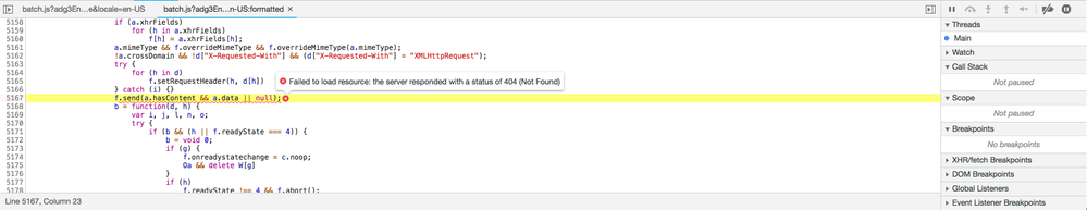

Hi, I'm writing a small application so that we can display a JIRA Wallboard on our TV without having to authenticate.

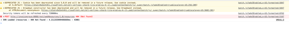

So what I'm doing is that I'm using CURL to get the contents of the URL of the wallboard using Basic Authentication. The authentication goes well and when I output the CURL content I get a javascript error as attached image. Does anyone know how to get around this issue or any other way to get our wallboard up on the TV without making everything public.

What happens when you copy the URL and access it on a browser? Do you get 404 error as well? I'm getting something like this on a browser:
{"resources":[],"unparsedData":{},"unparsedErrors":{}}
The thing with cURL is that it does not wait for any script to finish executing - it will just hit the URL and immediately provide you the page content.

Hi, If you take a look at the screenshot, that is exactly what I have done.
No 404 error.
