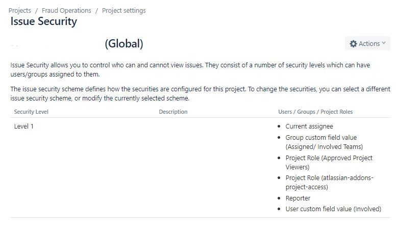

Can you provide details about the issue security level you have assigned to the issue, and the details of the Permission Scheme for the project?
I want to try to recreate the issue in another Cloud instance.

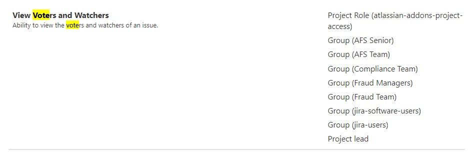

Thanks Trudy, attached the settings and see if you can figure what is missing?

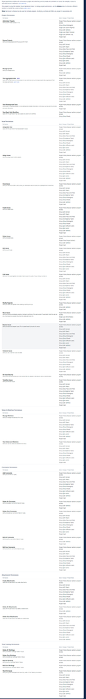

Unfortunately the print in the Permissions Scheme image is too small to read, and zooming in makes it too blurry to read. Can you provide that in sections in multiple images?
Also, through which of the Users/Groups/Project Roles of the Level 1 security level are you gaining access to view the issue?

Indeed I can see the image got compressed and lost resolution. I search for "vote" and the only thing related to this topic is only here and I got all the relevant group in already so very strange.
cny.jfif

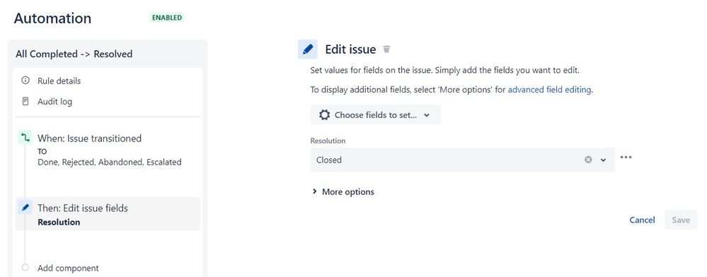

Thanks. I got this one, is there a way to simply adjust this rule and not creating a new rule to change the ticket from Closed to Open? cny.jfif
Trudy P Claspill
February 16, 2023
You need to clear the Resolution field, not set it to "Open". If the Resolution field contains any value then the issues is considered "resolved" (for purposes that look at the Resolution field). It is only when the Resolution field contains no value at all that the issue is considered "unresolved".
When you put the Resolution field on a screen you are required to set a value for it. If you have the field on your Create Issue or Edit Issue screens, you will be required to fill in the field, which would then make the issue appear always to be Resolved.
You can't use Automation to clear the Resolution field without adding it to the Edit Issue screen. And once added to that screen, then you are forced to actually fill in a value.
So, to clear the resolution field you need to instead do that through Workflow Transition Post Functions.

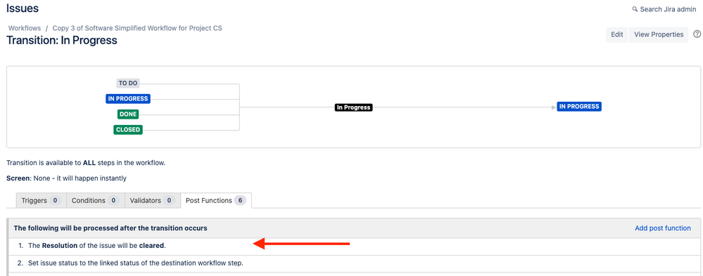

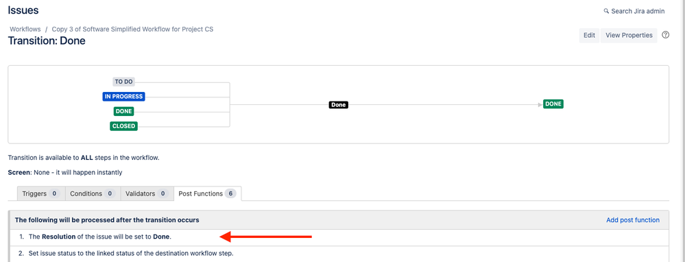

As an example, any transition to a green/done status would include a Post Function like this:
And any transition to a not-green/not-done status would include a Post Function like this:

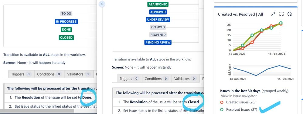

What is the difference if I set the resolution to "Done" or "Closed" my objective simply want to get this chart working so it will count all my green status tickets as Resolved in this chart.
Before I got the automation rule in place, every time when a ticket is in green status (Rejected, Done or abandoned) it wont appear in this chart. If I can set this up in post function that would be idealcny.jfif

The actual value of the resolution is not important.
You could call your Resolutions done, complete, deaded, duplicate, Bob, Kevin, Stuart, Mr Flibble, or even "unresolved", and the issue will be seen as "resolved" by Jira.  It's a simple "filled or clear" binary flag.

Resolution is set in two ways:
A post-function sets a fixed resolution during a transition.  In your screenshots, I would recommend using "set resolution to abandoned" on any transition into the abandoned status.  Or "duplicate" if you have a "close due to duplicate" transition.
Transitions can have a screen associated with them.  If you put the Resolution on a transition screen, the human gets to choose from the list of resolutions.  It is not "mandatory" in Jira-speak, but there is no way for them to leave it blank.
The second is useful when you don't want loads of end-status in your workflows.  It's for doing things like "Status = closed because we fixed it", "Status = closed because we cancelled it", "Status = closed because we found a duplicate".   One neat end status, but with reporting on why it's at the end.
Never use both on the same transition - the post-function will destroy what the human chooses.

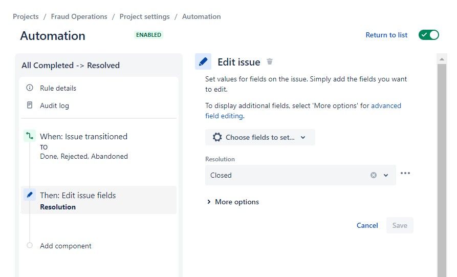

I just realized one of my projects is "Team managed" there is no  "Resolution" field to set a rule to "Closed" and nothing like a post function... Is there a way to set a green status ticket to appear as Resolved in Team managed project?cny.jfif
Nic Brough -Adaptavist-
February 16, 2023
Yes, team-managed functions simplify this (and a lot of other stuff that makes them pretty much isolated, and not useful for an enterprise).
Go to the board and edit the column settings.  You can tick one of the columns to have them set a resolution automatically.  (There's a way to get many columns resolved, but it's best to not do this - just tick the very last column on the board and keep it simple)

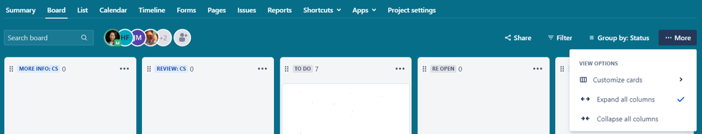

Still not able to locate the configured board in TMPs, where could this hide?1.png
February 18, 2023
Ah, this is a Jira Work Management project.  These do not have any column customisation options.
Unfortunately, there's (another) howling bug in TMP JWM projects - they don't set resolutions.

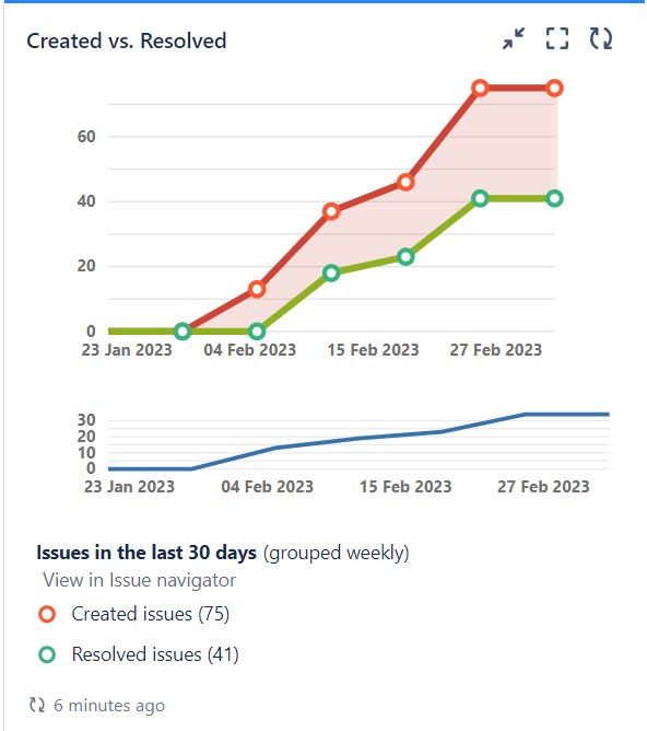

To summarize:
Created vs. Resolved chart depends on the Resolution field. If the field contains any value, the issue is considered Resolved. If it has no value, the issue is considered Unresolved.
We have learned that Voting is also disallowed when the Resolution field is set. Instead of being disabled, though, one can click the Vote button and one will receive an error message.

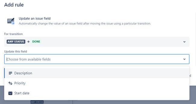

The Work Management projects (Company and Team Managed) do not have any automation built in to set or clear the Resolution field (or the Resolved date/time field). This is noted in https://jira.atlassian.com/browse/JWMCLOUD-180
You can use an Automation Rule to set the Resolution field, but you can't use an Automation Rule to clear the Resolution field. This makes it difficult to manage the Resolution field for Team Managed projects where it cannot be forcibly managed via the Workflow and only set, not cleared, via Automation. This is noted in https://jira.atlassian.com/browse/JSDCLOUD-8523

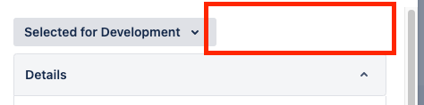

The space next to the OPEN status button is where the value of the Resolution field displays. If the field contains ANY value, regardless of what that value is, then the issue is considered Resolved and you cannot vote on it.
When the Resolution field is empty then absolutely nothing will show in that space, like this.
The fact that you see a value there, and there is a green checkmark, indicates that the Resolution field does have a value in it. Therefore, Jira considers the issue Resolved.
It looks to me like your administrators have added the Resolution field to your Create and/or Edit Issue screens. It should never be on those screens. When the field is included in the screen Jira forces you to select a value. The only screen that field should be on is a screen associated to a Workflow Transition to green/done statuses.
You need to clear the Resolution field to enable Voting on a not-done issue. For a Team Managed project the only way to do that is for the issue to be transitioned to a not-done status. For a Company Managed project you need to ensure that the workflow transitions to not-done statuses are clearing the Resolution field as a Post Functiion.
