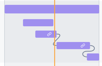

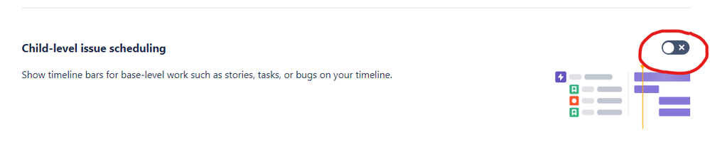

Is there a particular format that you're aiming for to visualise your requirement? If not, then the improved Timeline on each Software project should provide you with the right level of detail. You'll just have to enable child level scheduling and you're all set (see screenshots below).
However, if you need a more granular detail that encompasses more than one project, you might need to get a marketplace app as Advance Roadmaps for Jira isn't inherently available for the standard version of Jira.
