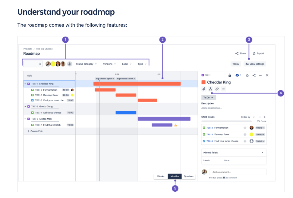

The image below as displayed in this support article leads me to believe this is possible but I cannot create the same visualization.
How do I recreate? Currently, I can only see child issue progress through the rolled up bar and task list underneath. I want a visual bar relating to the epic beneath which corresponds to the start and end-dates I set.

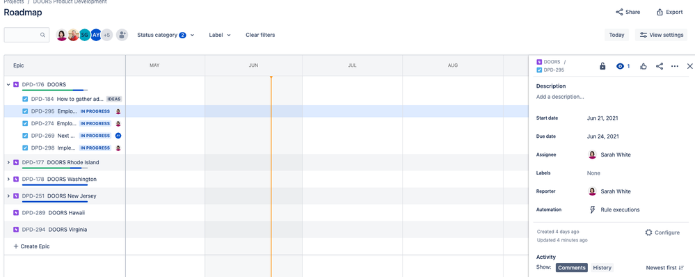

My current view which I would like to visualize as shown above.
