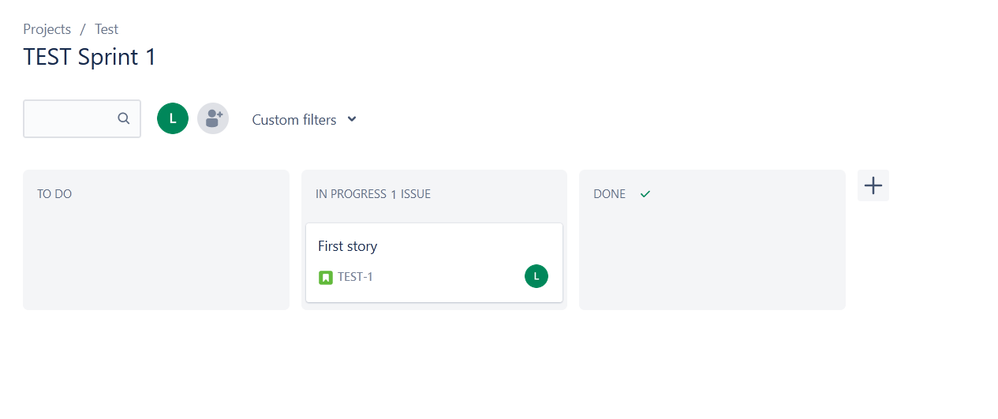

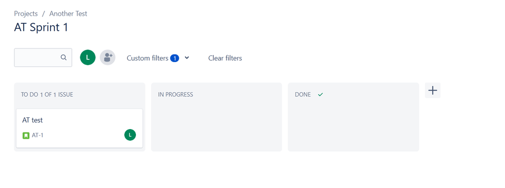

I've been trying to figure out how to view all of my project tasks on one board.

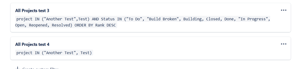

I've tried creating a filter as simple as
`project IN (project1, project2)`
but that didn't work.

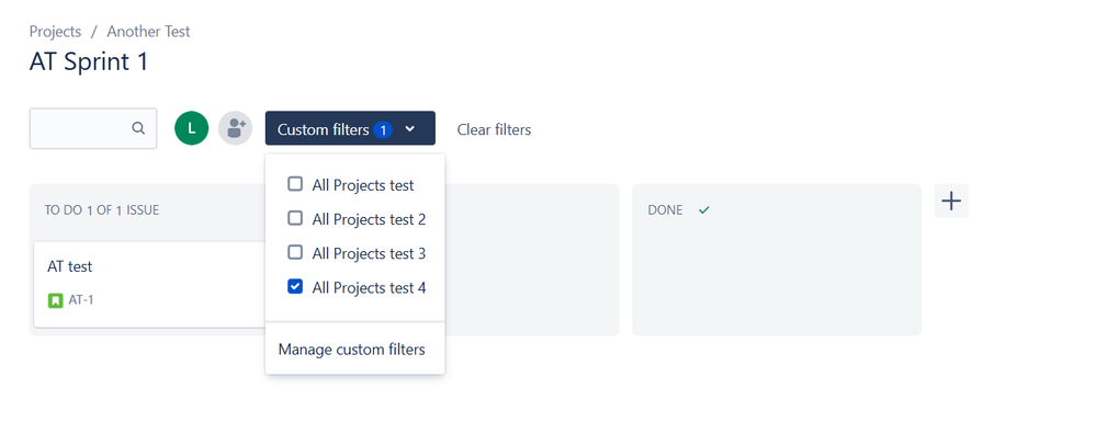

Here you can see the two different versions of that filter I tried along with the separate projects with a task on the board. I'm unable to see the other project's task with the filter on.
Maybe there's another way to do this or I've misunderstood how this filter should actually work. But in general I just want to be able to have separate projects with their own epics, tasks, etc, but also be able to enable showing all tasks at once on one board.
firefox_rvYKLVzUkW.pngfirefox_8DwFMCUV31.pngfirefox_FdSPn5COen.pngfirefox_VGgSJ0oqYm.png

I haven't been able to get it working still. I haven't touched the board configuration at all outside of the default settings. I just went with the scrum board project template and the project type is team managed.
If I type in the same filter on Filters -> Advance Issue Search and make sure to switch to JQL, the tasks I created on each individual projects' board show up. But still when I choose any of the filters I've made on either project's board it only shows the task I've made for that specific project.

What is your board filter and what are your quick filters?
Lee
May 24, 2022
The filter I was using is the same one in that first picture under test 4. I only see an option for custom filters for a board.
