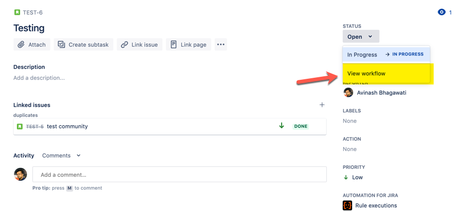

Avinash Bhagawati _Appfire_
November 20, 2019
Hi @ashley.sargent ,
Welcome to Community !
Along with @Jack Brickey suggestions you can view current flow in the issue. Please refer below screenshot for your reference.
Thanks,
AVinash
