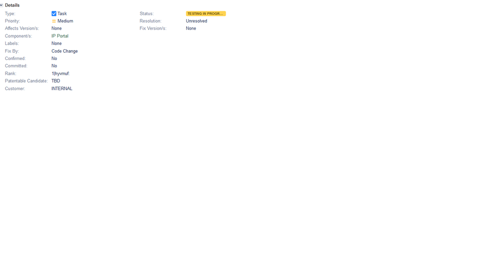

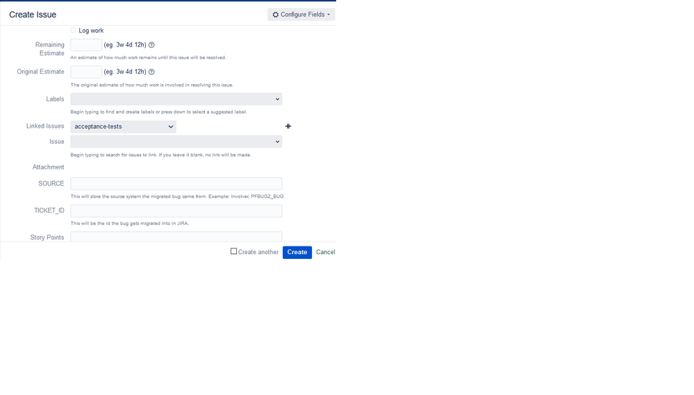

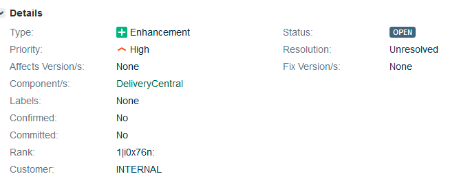

  1. Created a kanban board
  2. Manage Board ->Configure board -> Click Issue Detail View ->Added Effort Estimate (In Hours) field
  3. Create Issue screen & Edit issue screen does not show the field I added above (Effort estimate) but shows Original Estimate & Remaining Estimate (screenprint attached)
  4. On Card layout fields related to estimates are not visible.
  5. Issue detail screen that shows on the right side on placing the cursor on any issue, shows the field that I added but does not show the Original Estimate field (screen print attached). The Effort Estimate field that i added is non-editable.(Screen print attached)
  6. When i add value in the Original Estimate as this was the available estimate field that is editable and shown in the Edit screen. this field was not shown anywhere in Issue Detail/ Card Layout.
My Need is to be able to enter estimate, edit estimate and view estimates for the ticket.
Now i have enabled time tracking but we are not using that feature.
