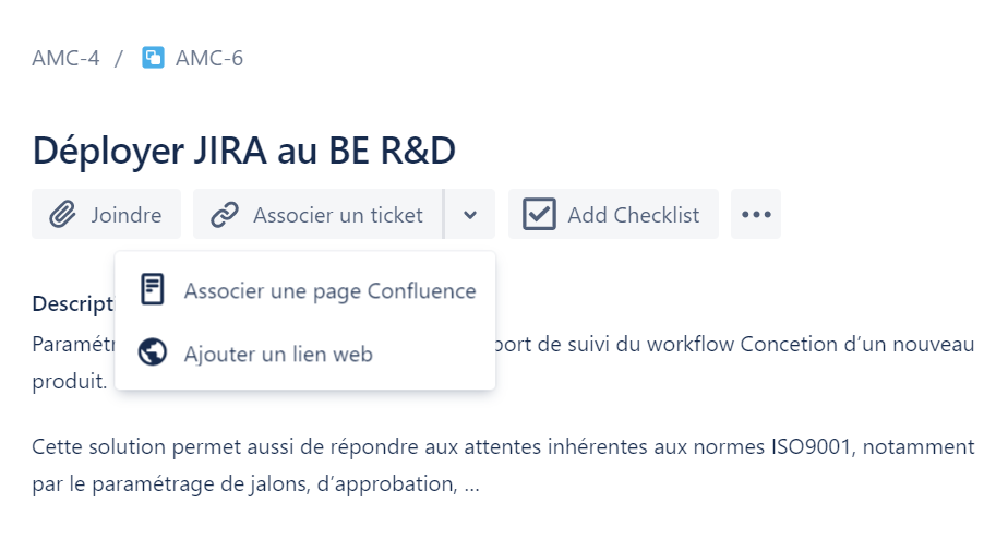

Quand on choisi Associer un ticket, on a le choix d'insérer un lien WEB.
Ensuite, les liens apparaissent dans un paragraphe Liens WEB.
C'est ce champ que je voudrais tester pour autoriser la transition de ticket vers un autre état.

"I've checked internally and I could confirm this information is called Remote Link, where you can add a URL to your Jira issue.
I've tried several different things on my test instance but I couldn't make this JQL to search for these remote links.
After that, I found a Suggestion that was closed as "Won't Do" do to the low traction on this suggestion.
A possible way to workaround on this would be to use an add-on, like the JQL Search Extensions that might have some functionalities that could allow you to get this information.
We also have an API endpoint that might be helpful: Get remote issue links"
