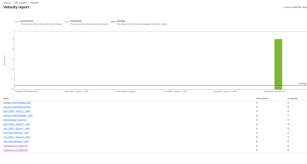

We have a company managed project. I have set board settings>estimation to story points. But at the end of a Sprint, when its closed, there is aren't metrics displayed.

The Committed value reflects story points assigned to standard work item types (not Epics or Subtasks) that are in the sprint when you click the Start Sprint button. It appears that there were either no issues in the sprints at those times, or they had not Story Points values.
The Completed value reflects story points assigned to the standard work item types in the sprint and in the column farthest to the right when you click the Complete Sprint button. Are there such issues in the right most column of your board when you are completing your sprints? It appears that there were for at least the Sustained Eng sprint.

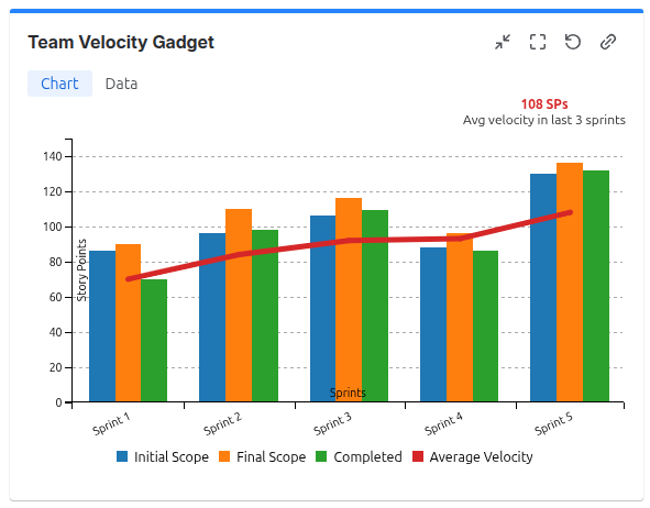

If you’d rather avoid struggling with these Jira reports, another option would be to try an app (plugin) from the Atlassian Marketplace.
If you'd like to try an app, our Great Gadgets app includes a Team Velocity gadget that works similarly to Jira’s report, but offers more advanced functionality, additional metrics, and a high level of customization. It may be worth trying to see whether the same issue occurs there as well.
