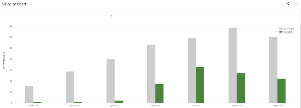

We have spent a fair bit of time reading documentation for how to properly setup Jira columns for the "Velocity Chart" to work correctly. I know that To-do items should always be the leftmost column, and completed items should always be the rightmost.
It seems like our Velocity Chart data is accurate once the sprint completes, but once we look back to 3 or 4 sprints ago, the data looks like many tickets/work items are just inexplicably missing. The further back, the more tickets are gone. Has anyone else seen or noticed this, or have thoughts as to what might be going on?
Picture for reference.

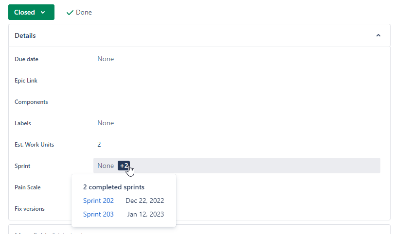

Here is what an item that has dropped off looks like. Notice the sprint has been set to None (nothing anyone on my team is knowingly doing).

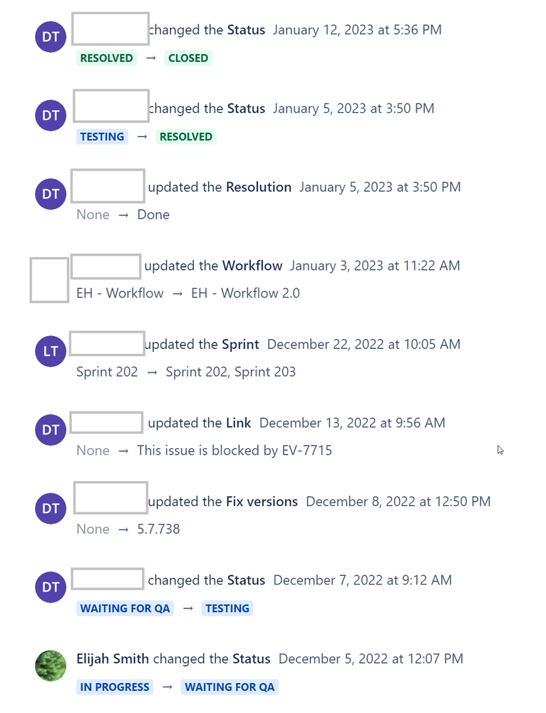

Looking at the example issue I see that it shows two previous sprints (202 and 203). What are the start and end dates of those sprints? And what is the date that the issue transitioned to the right-most column of the scrum board?
If the transition date is not within the range of the sprint, then the issues was "completed" outside of a sprint. In that case it should show up in the Committed points for each sprint to which it was assigned, but would not show up in the Completed points of any sprint. The Sprint field will also show as None (+ for history of previous sprints) for a completed issues when issue is "completed" outside the scope of a sprint.

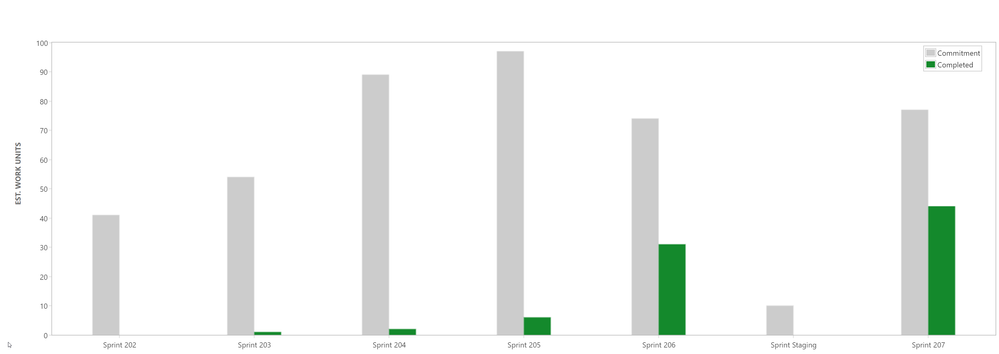

@Trudy Claspill , here is our current velocity chart. Notice how Sprint 202, which previously had ~30-40 completed issues, now has 0.

Sprint 202 went from Dec 2 to Dec 22. Here is the history on an individual issue:
Note, "Waiting For QA" is the first status that is in the right-most column. After that, "Testing", "Resolved", and "Closed" all also map to the right-most column.

I'm not entirely clear what happened to this issue on Dec. 22 related to the changing of the Sprint field.
If the issue was in sprint 202 and in the right-most column, and the sprint was then completed, the issue should've been considered "completed" in the Velocity Chart and in the sprint report for sprint 202. It should've "disappeared" from the board. How did it get assigned to another sprint (203) if it was no longer on the board? Or am I incorrect and it did not disappear from the board when sprint 202 was completed?

However, looking at the individual ticket example I gave above, this does not seem to be the case. You can see it moved into Sprint 203 on Dec 22 even though it was in TESTING.

Is it possible that the mapping of statuses to columns was changed? On Dec.22 might the Testing status not have been mapped to the right most column? If that was the case, then when sprint 202 was closed the issue would have been considered incomplete, and may have been moved to the next sprint (203). And in that case it would not be counted in the Completed issues for sprint 202 in the Velocity Chart.

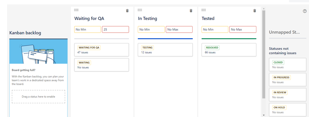

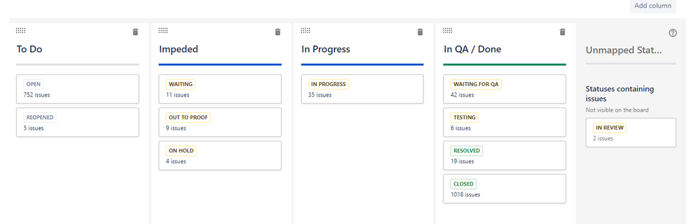

Do I understand correctly that you have 2 boards for the same issues, and these boards have different status/column mappings? Can you share the column/status mappings for each board?
I would not be surprised if having two boards for the same issues, using all the same statuses but mapped to columns differently, and using sprints in both, could have unexpected impact to your sprint reports.

Dev Board column mapping:
QA board column mapping:
