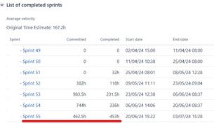

Hello!
I feel there is something amiss in the velocity charts i.e. committed vs completed hours reflected. So I tried to download the values in excel and match them. They do not match - clearly I am missing something. Can you please help me understand what's the issue or how to better read the reports?
How we add estimates:
  • Story, Bugs : We look at the Sum of Remaining Estimate field as we have sub-tasks
  • Task: We look at the Remaining Estimate as we do not use sub-tasks

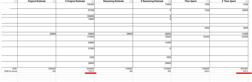

When I downloaded the parent items from Sprint 55, I would expect the following:
Committed value = Sum of Original Estimate
Completed value = Sum of Time Spent
What am I missing?
/RR

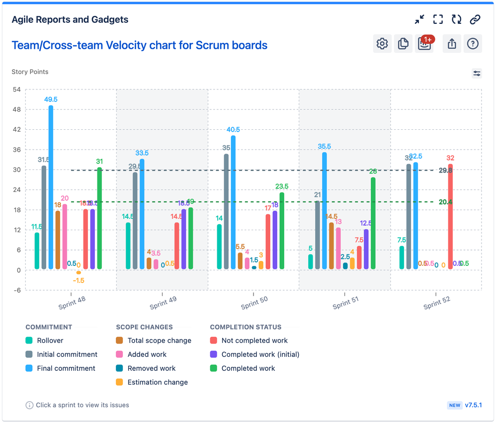

Hi @Rashmi Ratnani
You cannot verify whether the calculated velocity in Jira is correct. You can only trust it or not.
As mentioned earlier, the complete calculation of sprint metrics includes processing historical data - issue change history.
Overall, the following math must work:
Final commitment = Initial commitment + Added work - Removed work + Estimation change where:
  • Added work - issue added into sprint after its start
  • Removed work - issues removed from sprint after its start
  • Estimation change - issue estimate changes inside active sprint
In our reporting apps Velocity Chart and Agile Reports we implemented such historical data processing in order to add those metrics explicitly to Velocity report/gadget, but I can tell you, that's more than a hundred lines of code)
When we perform a cross-check with Jira numbers, in most cases if we have a diff, it is our issue, not Jira's.
Hope this helps.
Vasyl

What the excel is about:
I pulled out the sprint backlog for Sprint 55, and took only the parent items from the backlog. Downloaded it to excel to analyse. Then summed up the columns. So I would expect
Committed value (in first screenshot) = Sum of Original Estimate
Completed value (in excel screenshot) = Sum of Time Spent
Hope this clarifies.
