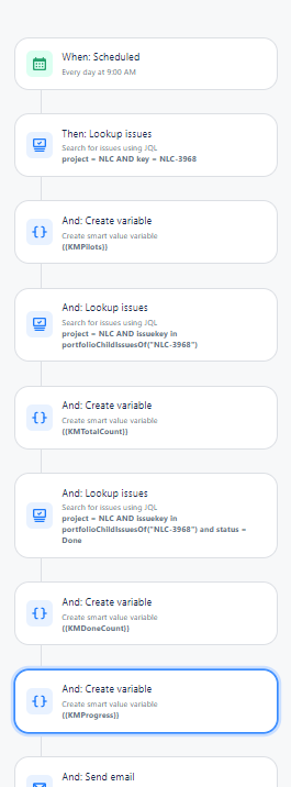

Sure, here is the whole automation rule picture:

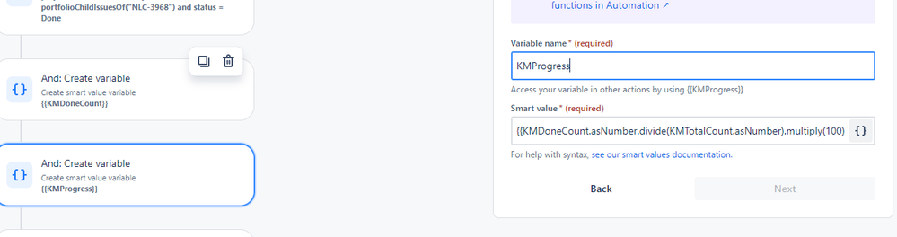

I have used suggested command below, this time the result was 0
{{KMDoneCount.asNumber.divide(KMTotalCount.asNumber).multiply(100)}}

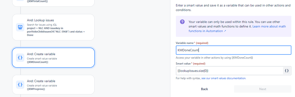

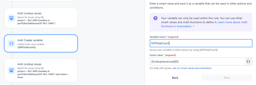

Variable KMTotalCount:
Variable KM DoneCount:
Variable KMProgress:

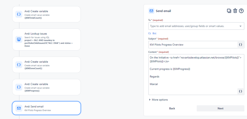

Thank just calling it all in the mail:

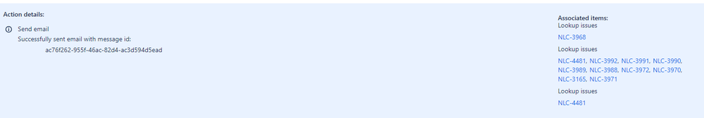

According to info in audit log, it seems to me that I am pulling the issues I want to pull

@Bill Sheboy I tried to investigate audit log, this is the only thing I see there:
And these are the items I am looking for - so not sure why I am not getting the calculation correctly.
