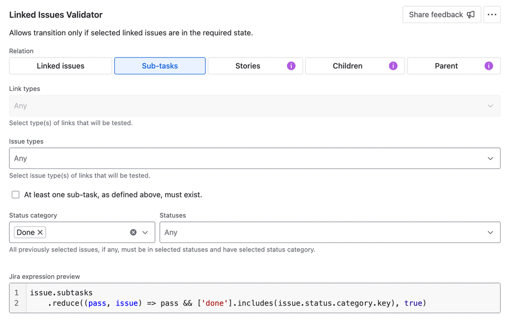

Hi @Mahnoor Arshad
If you’re working in a company-managed project on Cloud, our team has developed the Linked Issues Validator for this exact use case. It provides a simple UI that lets you block a transition until the selected related issues (in your case, sub-tasks) are in the required status.
It also allows you to create a custom validation message that is shown to the user when they attempt a transition and the conditions are not met.
In case you’re interested, here’s how the UI looks:
At the bottom, you’ll find an expression preview that is automatically generated for you. You can also reuse this expression if you decide to work with other tools.
I hope it will help!

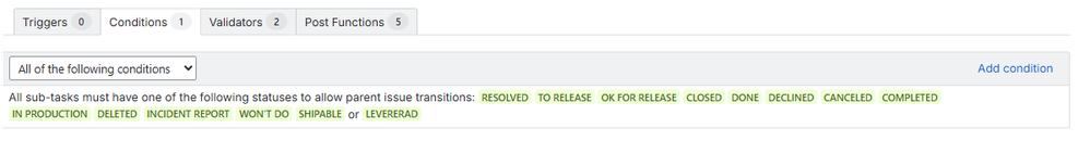

Hi @Mahnoor Arshad
Just to add to what @Trudy P Claspill describes above. You can add a condition directly in the workflow that all Sub-task needs to have a certain status before allowing the transition.
The drawback is that the user don't get any error message, the transition is just unavailable until the conditions are met which might cofuse users.

Mahnoor Arshad
September 4, 2025
@Staffan Redelius
I have tried this option, however it will hide the transition from the user which is something I do not want in the process. And it would be a nice to have an error message appear.

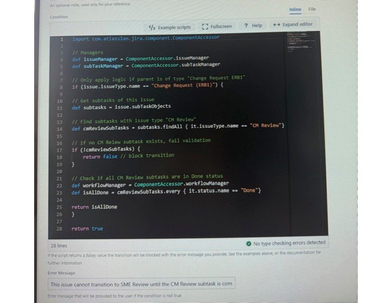

Mahnoor Arshad
September 4, 2025
Hi @Trudy P Claspill
I have Scriptrunner. I have written a simple scripted validator to help achieve this however it does not seem to be executing properly.

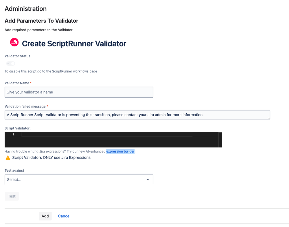

Trudy P Claspill
September 4, 2025
Hello @Mahnoor Arshad
Thank you for that additional information.
The tags on your post indicate that this question concerns Jira Cloud.
Can you confirm that this is for Jira Cloud versus Jira Data Center? The screen I have in my Jira Cloud instance for adding a ScriptRunner Scripted Validator to a workflow does not look like the image you provided.
Notice that mine has the field for the message above the scripting area.
