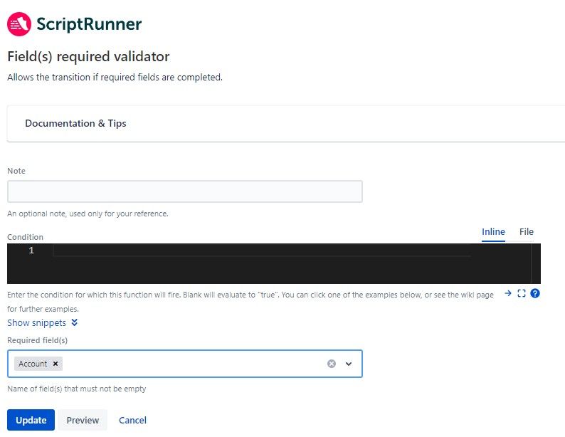

Evgenii
September 11, 2023
Hi, @Selcuk Tayar
Sure, it is possible

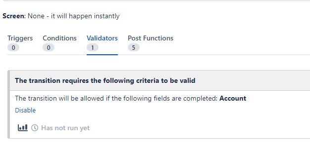

You can use SR validator, on necessary transition. I used another field for example, you have to select what you need.
This validator checks, that value of field is not empty.
If you want to check for field value, validator will look slightly different.
