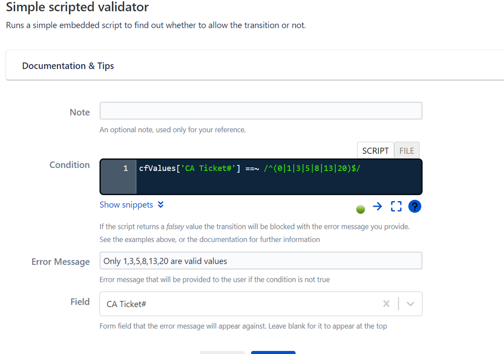

Vikrant Yadav
May 25, 2021
Hope this screenshot helps you.
