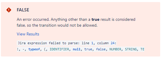

Hi Team,
Forgive me if it comes up as a silly question since I am a complete beginner to Scriptrunner. I am trying to add the following validator script to Workflow but getting the following error.
cfValues['Sub-Status']*.value.contains("On hold")
Here 'Sub-Status' is a checkbox field having only 1 value 'On hold' currently.
Could you please help me with the solution?

Kristian Walker _Adaptavist_
May 20, 2021
Hi Danish,
Thank you for your question.
I can confirm that the reason for your error is due to your validator expression is not valid code for Jira cloud and is groovy code that will only work on Jira server.
I can confirm that inside of Jira Cloud that validators are designed using the Jira Expression Framework and you would need to use this expression syntax to define the validator that you require.
I can confirm that we have a knowledge base article located here which explains how you can use this to create the validator that you want with ScriptRunner for Jira Cloud and I hope this helps to achieve your requirement.
I hope this information helps.
Regards,
Kristian
May 20, 2021
Hi Danish,
I have added an example here on line 55 which shows gow to validate that a checkbox field must contain just a single value.
Please note if you need to change this example you will be able to modify this using the Jira Expression framework doucmentation as an example to help you to modify it using the Jira Expression framework doucmentation as a guide to help you to achieve this.

Danish Hussain Sabunwala
May 20, 2021
Hello @Kristian Walker _Adaptavist_ ,
Thanks a lot for your help. The following code provided the answer I was looking for.
May 20, 2021
@Guilhem Dupuy , Yes it will be possible by using Scriptrunner Validators. But still not able to understand the above error.
Guilhem Dupuy
May 20, 2021
@Danish Hussain Sabunwala as I said I'm no Scriptrunner expert I can't really help you with the code unfortunately I was just proposing a work-around :/
The column 24 seems to point to the "." character, but I don't understand why either :/
