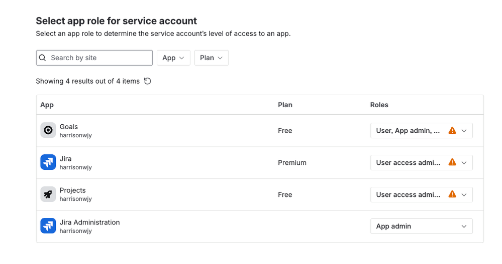

During the creation of service account, I have grant all roles to my service accountScreenshot 2026-02-19 at 3.04.38 PM.png
In addition to that, I also created an API token with the scope of `read:jira-work` (needed for Get issue api)
However, after doing all these, I am still facing 404 issue with "Issue does not exist or you do not have permission to see it."
Was wondering what else did I missed?
