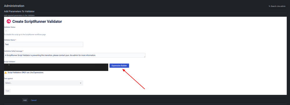

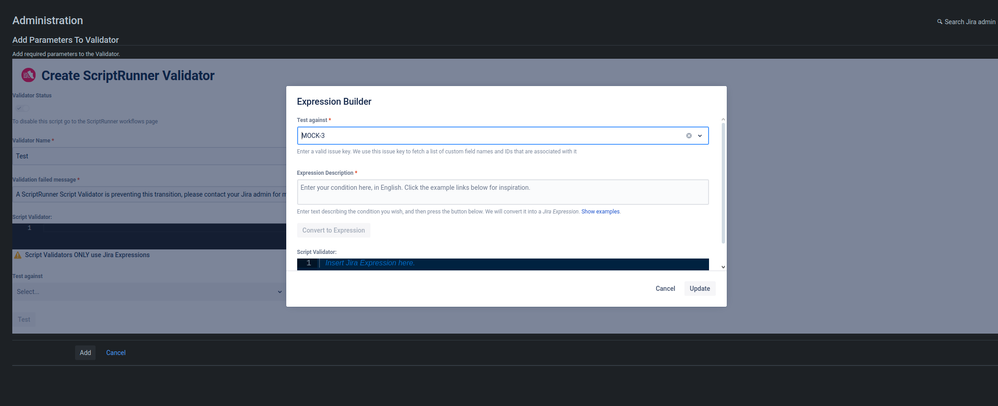

Alternatively,  you can also use the in-built Expression Builder in the validator as shown in the screenshots below:-
I hope this helps. :-)
