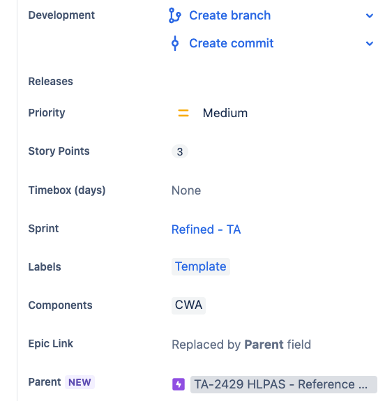

To get the sprint ID, I did a search on all issues in that sprint, and the JQL replaces the sprint name with the ID.  (I changed the  sprint name to "Refined - TA" to ensure the name was unique, as there are lots of sprints from other projects called just "Refined"). I used the ID in the post function, and the ticket I moved to "refined" status then shows the correct sprint name (see screenshot).

Hm. So, it does show the correct sprint in the issue details.
But in your original post you said
"If you click through from the ticket to the associated sprint, it is instead appearing on a board for a different, unrelated project, which does not have a sprint with the same name or ID"
So, in your image above if you click on the "Refined - TA" sprint link, you end up in another board, not the one where you created the Refined - TA sprint?
