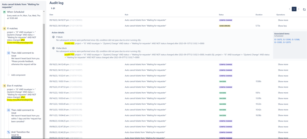

Hmm, I got an error in the logs: No subsequent actions were performed since JQL condition did not pass due to error running JQL.
Also, in the "if" block, I entered a JQL condition: project = "IS" AND status = "Waiting for requester" AND NOT status changed after {{now.minusBusinessDays(3)}} and got a warning: If smart-values are used JQL can not be validated.
@Rudy Holtkamp am I entering something wrong or is it not possible to use smart-values in automations?

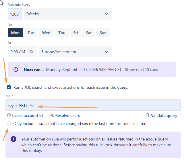

@Igor Kolpakov , you did nothing wrong. It is just that if you add a JQL (without smart values) it can directly show which issues are included in you JQL (In the edit mode of the automation rule). It can't do that if you use a smart value, however you can run the rule and verify if it works.
HINT: I use a 'scheduled' trigger to test if my automation works on a sub-set of issues (preferably 1). You can do this like the picture below
1. Set the run rule every to an insane value, so it does not accidently trigger
2. Use run a JQL and include one or multiple test issues with key = KEY-1
or with key in (KEY-1, KEY-2)
3. Remove the 'Only include issues that have changed' check.
Good luck

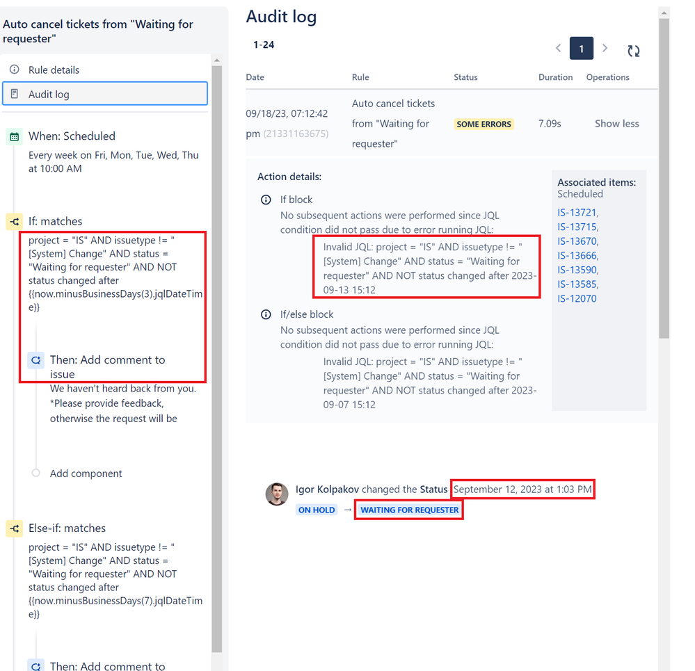

I clicked "Audit log" in the automation and after changing the configuration there is an error: No subsequent actions were performed since JQL condition did not pass due to error running JQL
If I understand correctly, the automation was not performed because I inserted smart-value.
Your datetime format is not correct.
Add .jqlDateTime after {{now.minusBusinessDays(3)}}
So it will read {{now.minusBusinessDays(3).jqlDateTime}}
This will produce a date time format which is accepted by the JQL: 2023-09-07 12:13
You also might need to add double quotes around the smart value.
I made an edit, but the rule did not apply anything to the request, although more than 3 business days have passed. Does it work with smart values?
UPD: I changed {{now.minusBusinessDays(3).jqlDateTime}} to "{{now.minusBusinessDays(3).jqlDateTime}}" and it seemed to start working.
Thanks for the update. So the double quotes were necessary.
