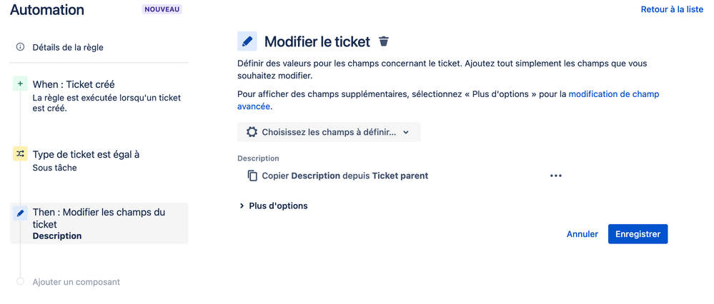

Hi @Zach Warf ,
Does your rule look like this :
With the value of your field being copied form "Parent issue", which is not default parameter ?

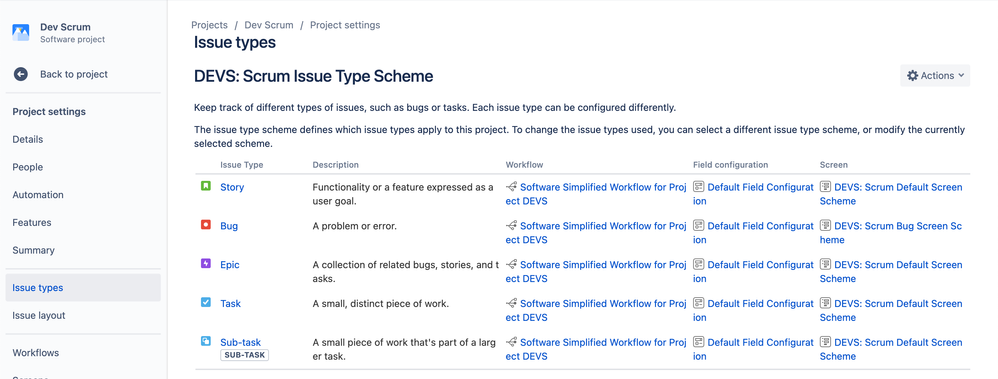

If yes, then can you can check from your project settings > issue types that your "Subtask" issue task is really considered as a Subtask issue task. You'll know it is if you get the little "Sub-Task" grey rectangle written below it in this setting :
Let me know if it helps,

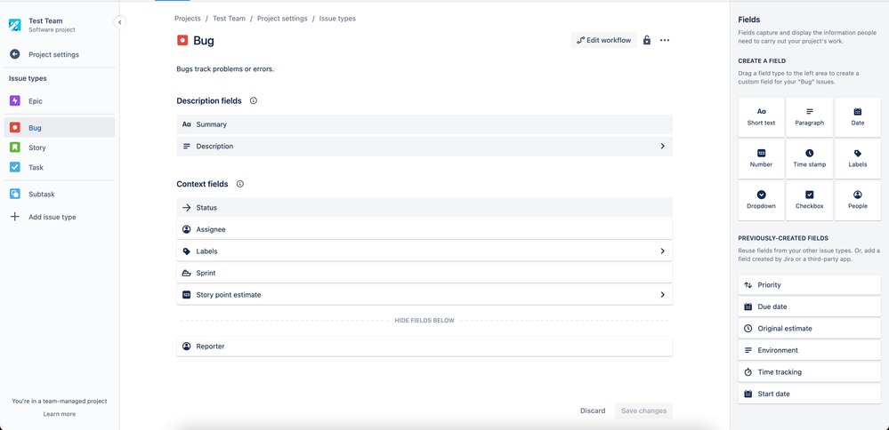

Guilhem! Thank you so much for the reply. My issue types/project settings screen does not look the same as the one you posted.
From the main project screen, I'm doing the same you mentioned above, by going to Project Settings > Issue Types, and I'm seeing below:

Hi @Zach Warf ,
It is because you are using a Team Managed project; this type of projects have a whole different way to manage automations that is more limited than the Company Managed projects :/
