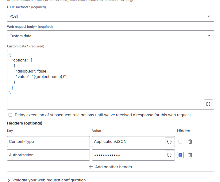

Then set up the request as such:
This will create an option in the custom field when a new project is created.
It would be beneficial to do the reverse for when a project is removed or archived.
Let me know if this has helped you achieve what you needed.

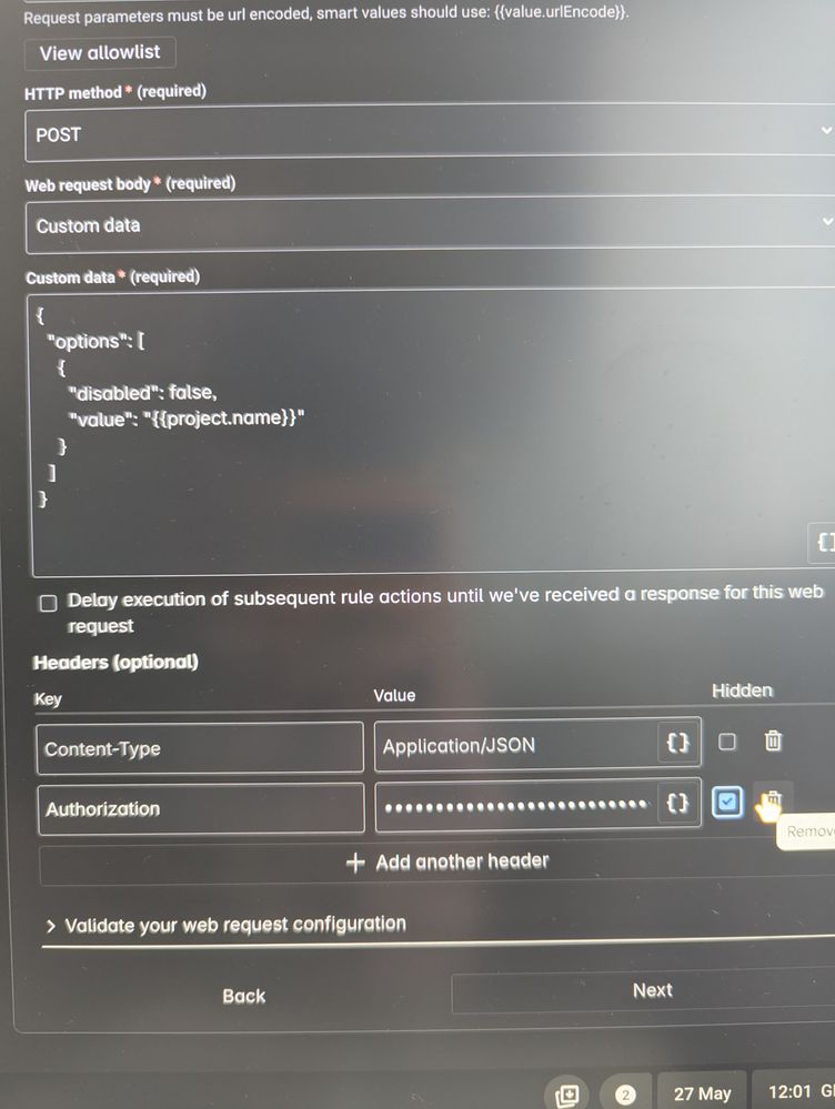

I think my url might me wrong. Can you check? I use my user as actor and my password as Authorization Value.
https://myinstance.net/rest/api/3/field/customfield_11255/context/1234567890123/option
I also tried the action as work item updated so that I can try the automation.
Thank you so much!
Aaron Williams
May 27, 2025
@İclal Aslan I am unable to check your instance name. But it will be in the URL before atlassian.net/
You then need to set up the authorisation like so using your "Basic email:API key" the email and API should be encoded for security.
İclal Aslan
May 27, 2025
Had to find the contextId but found it and worked like a charm! This is great! Thak you so much for your help!
