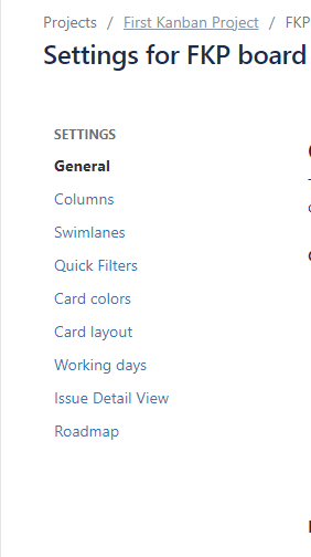

KAGITHALA BABU ANVESH
January 19, 2021
Hi @Peter Audooren ,
Story points estimation is done for Scrum projects.
story point estimation is not available for Kanban Project templates. as we check in board settings, The estimation is missed in Kanban,
