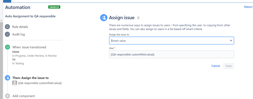

On the project I have a custom field "QA Responsible"of the type - User Picker (single user).
Now I want to use Jira Automation so that
when issue transitions
the Assignee of the issue changes, to the value from the field "QA Responsible".

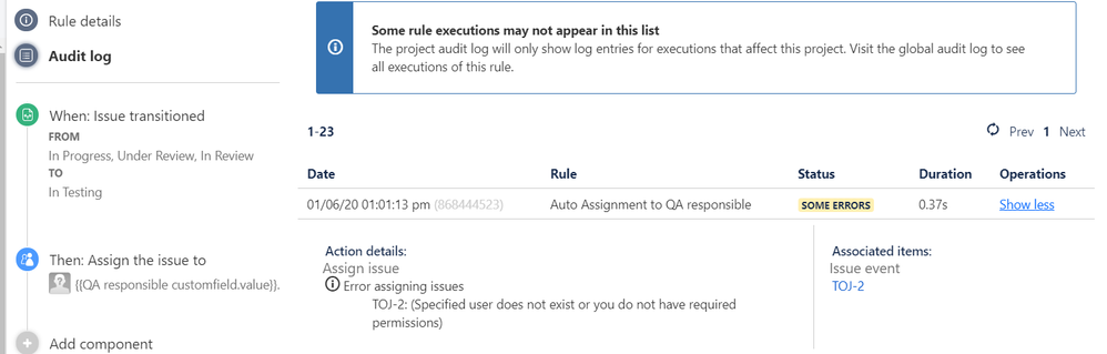

I have configured the below , but not getting the desired results

Are you able to assign the issue to the user doing it manually? It looks like the user you are trying to assign the issue to by Automation does not have that permission. You can verify with the Assignable User permission in the Permission Scheme attached to the Project.

vshah
June 1, 2020
I think this is something to do with the custom field , after modifying the formula the assignee field is getting blank - unassigned and the audit log is showing success.
So probably, automation is not identifying the value from the custom field 'QA responsible' which is User Picker (single user) type.

Probably so. Can you share a screenshot of the details of when you are setting the value of the field?

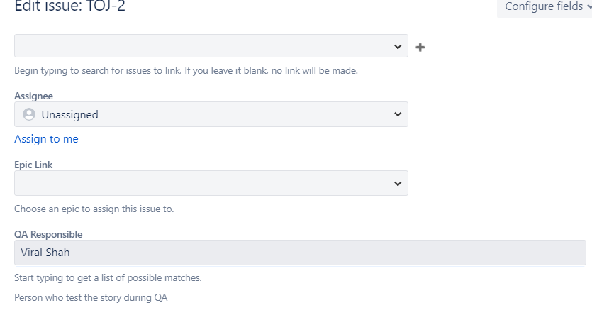

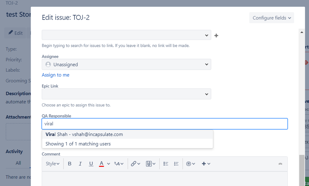

vshah
June 1, 2020
QA Responsible field value :Before
John Funk
June 1, 2020
Sorry - I meant the details of the Rule itself - for the Then Assign issue to component.
vshah
June 1, 2020
John Funk
June 1, 2020
Your syntax is wrong there.

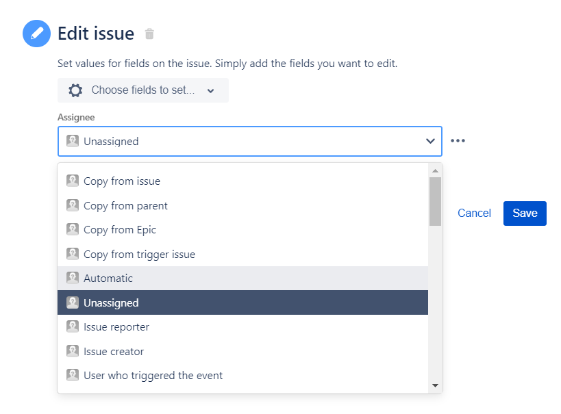

I think I would rather do an Edit issue component instead of Assign the user.
Then you can edit the Assignee field to copy from the QA field. If that doesn't work out we can go back to the this option and work out the syntax.
vshah
June 1, 2020
John,
In edit issue,  we dont have the option to update the assignee to a custom field. So I chose to Assign the Issue. Can you help me with the syntax ?
John Funk
June 1, 2020
Choose the Copy From option from the three dot menu on the right.
vshah
June 1, 2020
Wow. It worked. Thanks a lot John.

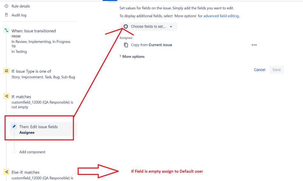

vshah
September 24, 2020
@René Lind
Let me know if you require anything else

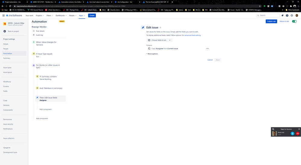

René Lind
September 24, 2020
Thanks for the reply @vshah
Here is the rule i am trying
In en Epic there is a field called Teknikere. Its at "User Picker (multiple user)
If that is updated i want specific issues attached to the epic to be reasigned to the first user in teknikere.
Its not working yet so any adwise would be greatly appreciated.
Regeards René
This is the rule so far
vshah

John Funk
September 24, 2020
I don't know of any way that automation could know which is the first value selected in the list.
You could probably create another rule that walks down the chain of people in the list and set the value of a new custom X user picker field.
Something like this for the multipicker Teknikere field:
John
Vshah
René
The rule would say if the value for Teknikere changes then have an If/Else:
If John, set new custom field X value to John
Else if Vshah, set custom field X value to Vshah
Else if René, set custom field X value to René
Then you could assign the card to the user based on the value of the custom field.
