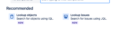

"Invalid JQL"? It looks like, you're trying to configure Jira Automation with JQL search.
You need to use action "Lookup objects", to find required assets.

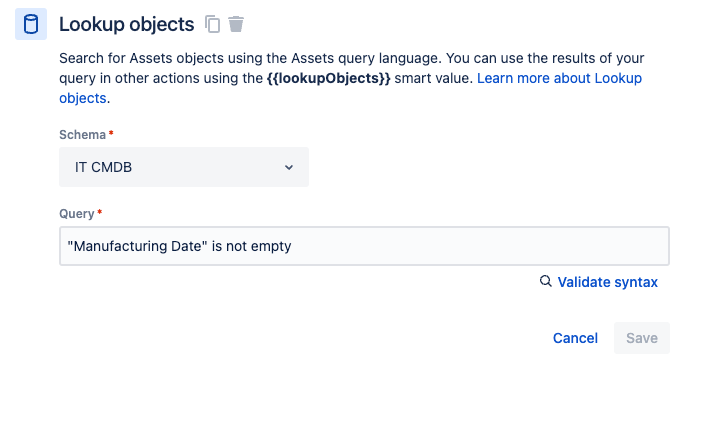

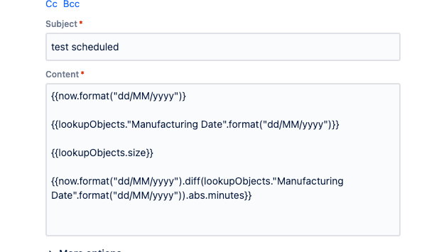

Yes, I get the lookup objects, and can print them out but am having troubles with date comparison now.
Attribute "Manufacturing date" is added with type "Date" from the UI of Assets itself.
I thought {{now.diff(lookupObjects."Manufacturing Date").abs.months}} would work, but it does not.
I tried printing what this would return (through send email), but it sends just the blank row.
Thank you.

Azur Mujezinovic
July 4, 2023
There are just 2 simple steps created.
When : Scheduled, monthly
Then : Lookup objects, from IT CMDB,
Condition : currently not using it because I an trying to get the right output in email, in order to know what is returned.
Send email. Email body is just me testing the outputs.

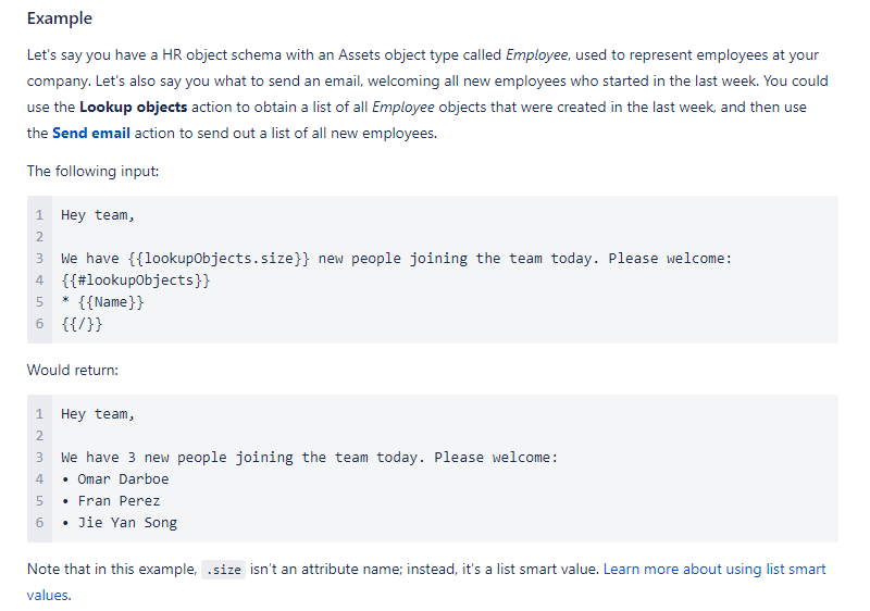

You have to look for assets (your second screen, Lookup Objects) with AQL search, and then use list of objects in email.
objectType = _your_assets_type_ AND "Manufacturing Date" >= startOfDay() AND "Manufacturing Date" <= startOfDay(24w)
Here is example, how to use lookup objects list:
https://support.atlassian.com/cloud-automation/docs/jira-smart-values-insight/#SmartvaluesInsight-Lookupobjects

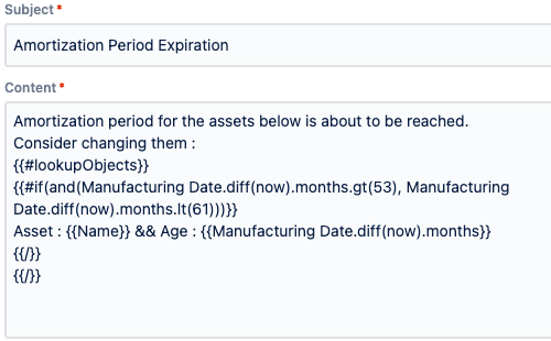

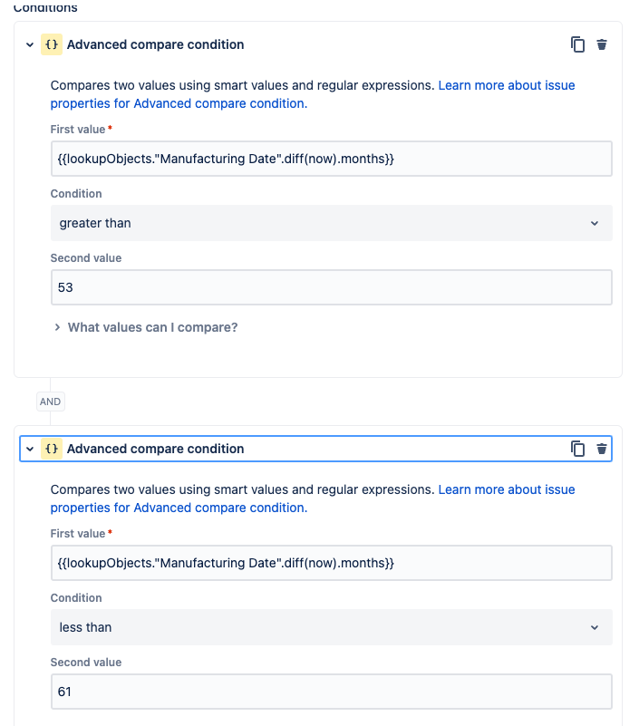

Azur Mujezinovic
July 5, 2023
Thanks for the help.
Managed to solve it with just a bit different approach.
Wanted to include the age of an asset in the email body too.
