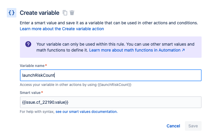

In any case, I've tried the initial steps of your idea.  So far, my variables are not set with my custom field values. I've tried variations of the syntax below attempting to set my "vparent" value from the field's value.
I've tried:
  • {{issue.cf_22190.value}}
  • {{issue.cf_22190}}
Each time, my automation "Succeeds" but I have no value in my variable in the audit log.  Note, i've tried this with two different custom fields as one is a number and the other is a dropdown/string.  I get the same result (null value) each time.

Hey, it's normal, the syntax is not correct, sorry I wrote an abbreviation
the correct smart value is : {{issue.customfield_22190.value}} for the parent value and {{issue.customfield_22190.child.value}} for the children.
If you have just a simple custom field (not a cascading list) you can just write {{issue.customfield_XXXXX}}
