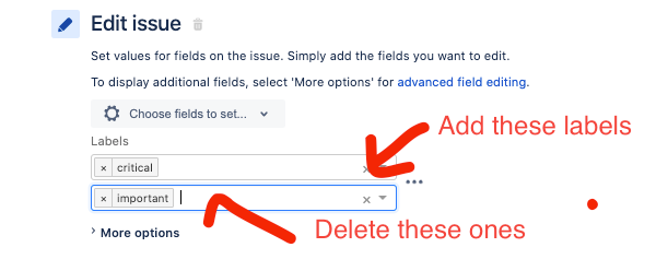

This is possible to do, within your Action you need to:
  1. Select Edit Issue as the Action
  2. Choose the field to set as "Labels"
  3. Press the breadcrumbs (3-dots icon) next to the drop-down field under the field selected - and select "Add/remove values"
  4. Enter the values to add / values to remove into their respective boxes
  5. Press Save
For clarity, this is how I created the rule:
  1. Trigger: Either "Issue Updated" or "Field Value Changed = Field"
  2. Branch: For Current Issue
  3. Condition: If Field = P1
  4. Action: Edit Issue - Labels, add Critical, remove Important
  5. Branch: For Current Issue
  6. Condition: If Field = P2
  7. Action: Edit Issue - Labels, add Important, remove Critical
Tested using the "Priority" field in our instance and it worked in both directions :)

Kristin Palmer
August 11, 2020
Fantastic, thanks Stephen - I tested this out and it worked. Screen shot for illustration purposes for people who come to search this post in the future. :-)
