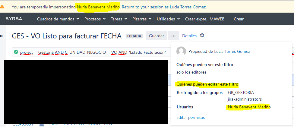

I'm facing the same problem and I don't get to the solution.
I have an user with edit permissions on a filter. But when he tries to Save the filter, an error shows.
The filter is used in a dashboard. I tried to give the user edit permissions on the dashboard but the problem still remains.
I'm using Jira Server version 8.20.12.

The message at the top is just a warning that you are impersonating another user. It is not an indication that the user can't save changes to the filter.
What happens when the user makes a change to the filter and clicks the Save button?

You can see the error message when trying to Save the filter in the first screenshot.
I'll just attach it again.
I have searched the error in atlassian logs in order to find some detail about it but it does not show up.

I apologize. I was looking at the image on my mobile device and did not see the message in the corner.
After changing the filter, did the user click on the Search button to the right of the filter to refresh the filter results?

Yes, the filter results are refreshed before clicking the Save button.
