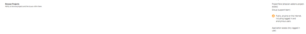

I've read other similar questions here and the solution seems to be - give them permission to browse projects. I have gone as far as giving permission to "anyone on the internet" and they can still not tag other users. What do I do?

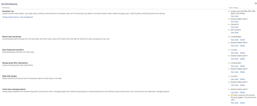

the user who tries to mention somebody must be in group jira-developers to make sure it works - from my understanding this is the only group which is able to "Browse Users and Groups" which is needed to do the mention.
Additionally the user who is to be mentioned needs to have Browse permission on the relevant project - this seems to be the case as (for a test?) you now allowed everyone (even anonymous users) to browse the project.
So my main question is: the user who wants to do the mention - is this user in group 'jira-developers'?

@Daniel Ebers I added another group, and that worked. I guess I need to allow it at admin level and not just project level.

By “tag” do you mean “mention”, I assume so. Can you share screenshots of:
  • your global permissions for browse - admin > system > global permissions
  • your project permissions page - project settings > permissions
what happens when you try to mention someone? Are you able to set the Assignee to someone that you are trying to mention?

I (admin) am able to mention users, but there are other users who are not able to. I've also added these users to a group that has had the permission, but it still isn't workingmention issue 2.PNG

Assuming you have admin permissions, can you check the global browse users and groups setting? You can find this here…
<your site>.atlassian.net/secure/admin/GlobalPermissions!default.jspa
Samuel Justus
July 9, 2021
@Jack Brickey I sent a screenshot above of that page.
