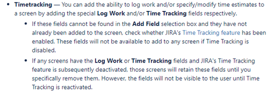

shetty
August 22, 2018
Kevin
August 22, 2018
Hi Ramesh -
Thank you so much for trying to help. I tried following the instructions in the documentation and I just don't have the options available that the docs say should be there. So I'm going to take the brutal option and just abandon this project board and start a new one. I've created a new project and that is working fine.
