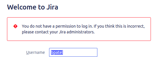

I have added LDAP directory.  I have two users in LDAP.

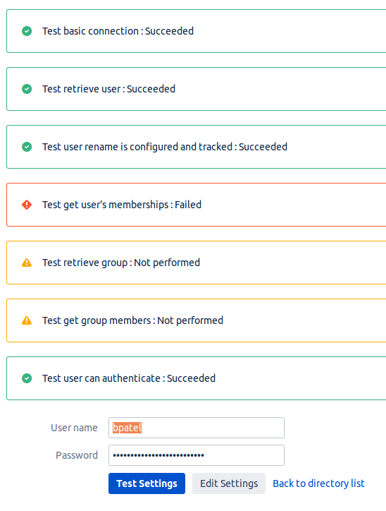

I dont find jira group for LDAP users. see screenshot 2.

Sorry to hear about this problem.  I can see you are looking to connect Jira to an LDAP user directory to bring some users into Jira, and it seems this user has been found, but is not permitted to login to Jira.
This tends to happen because Jira grants user access to login by group membership.  And while it certainly looks like Jira has found the user object in LDAP, and the password looks good, the only other reason Jira would deny login would be because Jira has not been able to establish that this user account is a member of a group that grants application access in Jira.  Details in Licensing and application access.  By default the group called jira-software-users grants access to that product, jira-servicedesk-users grants application access (Agent role) to those users, and jira-core-users grants application access to Jira Core.  If the user account in question is not a member of any of these default groups, or any other groups your environment might have defined to grant application access, that account can't login to Jira.

Most basic approach is to first understand what groups that user is a member of.  You can do this by going to the User Management page /secure/admin/user/UserBrowser.jspa and search for this user.  It should identify the directory this user account is found in, and any groups they are a member of.   I think your screenshot #2 shows this without any user groups, but it seems cropped so I'm not sure.

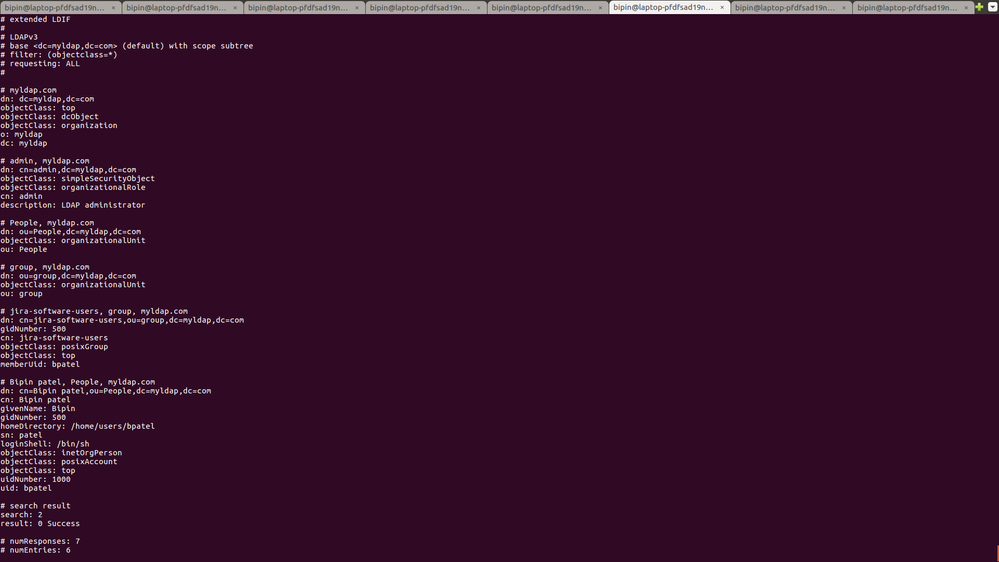

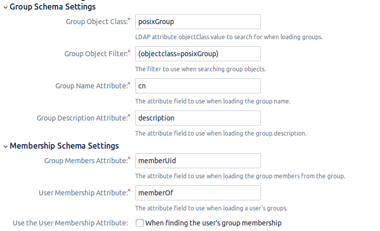

Here I am adding more details. I am sharing jira ldap settings and ldap search results.
JIRA LDAP settings:
LDAP search results:
OpenLDAP GUI:
Looks like my group object class is not correct. Also I don't find memberships  attributes (memberOf) in openLDAP.

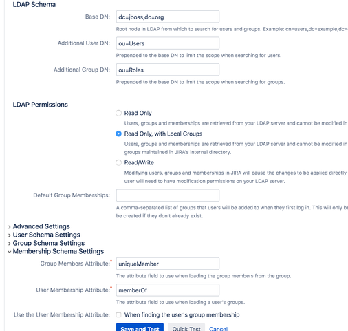

I'd also be curious to see your Base DN value, Additional user DN, and Additional Group DN values you have set in Jira here.  Here is my example openldap:
